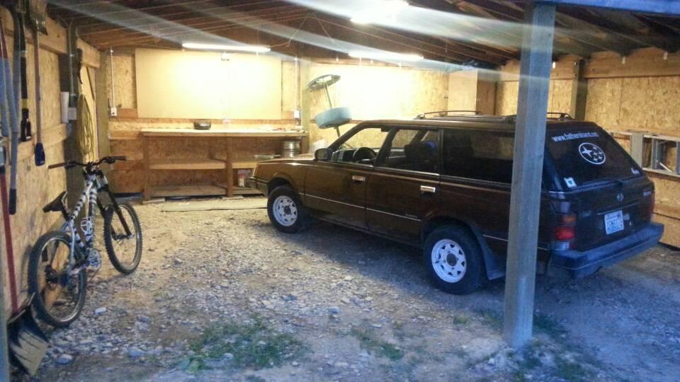

  11. okay, guys. first, i want to thank you all for your geat posts and the superb threads i have read on here. here's the deal. bought an 86 gl 5spd 4wd hi-lo. doing the weber conversion, ripped out a bunch of stuff, put some back the way ive seen on some of these threads, reached a dead end. got the weber on, got it all connected, but still need some clear pictures of where to run the final lines of vacuum hoses, what all needs closed off, what needs to stay. ill put some pictures on here in a little bit to show what ive got done. thanks for any help you can give. i need to finish her this weekend. love this forum!!! ~awdwagon
