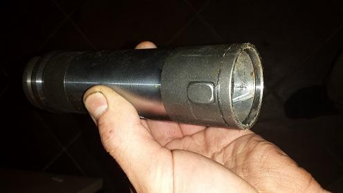

  4. With a little more inspection and measuring the new transmission and the old one... I have come to the conclusion that the tube is pushed over the step in the tube and cannot be easily removed without opening the case. It might be going to a transmission shop.
  5. Well... Hello, Yes this is my first post and yes I would not be posting on a Subaru forum if wasn't having an issue. I am a mutli-subaru (01 legacy GT and 09 Forester) owner and I do all of my own work on my cars since I am moneyless. Now, the issue that I having has to do with the replacement of the transmission in my 09 Forester. Before I dig into what the issue, I will say that I had a 98 legacy outback wagon that I did a transmission on about a year ago with no issues. So I pull the old transmission on the 09 Forester and go to put the "newer" one in. Assuming that the torque converter was seated, I bolted the bell housing up. I go to put the torque converter bolts in from Access hole on the rear of the engine. I put the first TC bolt in with no issue. I then go to turn the crankshaft with a ratchet and it turns but is very tight. So I loosened all of the bolts on the bell housing and pull the transmission back about a 3/4". Now the crankshaft will spin without any issues. So I pull the transmission and TC back out of the car and assess the situation. The TC came out of the transmission without an issue but the retaining clip was mangled and the tube that attached to the TC was still in the transmission. I am able to get a pick behind the "nub" on the tube and attempt to get slid it out but it will not move. So I got a piece of pipe and notched it out so it would slide in and lock around the nub on the tube. I tried to pull and tap lightly on it and it will not budge. When I put the TC back into the transmission and try to spin it, it does not move by hand. If I put a couple bolts in it and use a pry bar to try to spin it, I can move it 180 degrees with a struggle. I am worried if I really hammer on the tube with the "tool" that I made it, that it will really mess things up worse. Attached is a picture of the Old transmissions tube. So my questions are... Has anyone else made this amateur move and how did you deal with it? Is the Transmission doomed? Any help is appreciated... Thanks!
