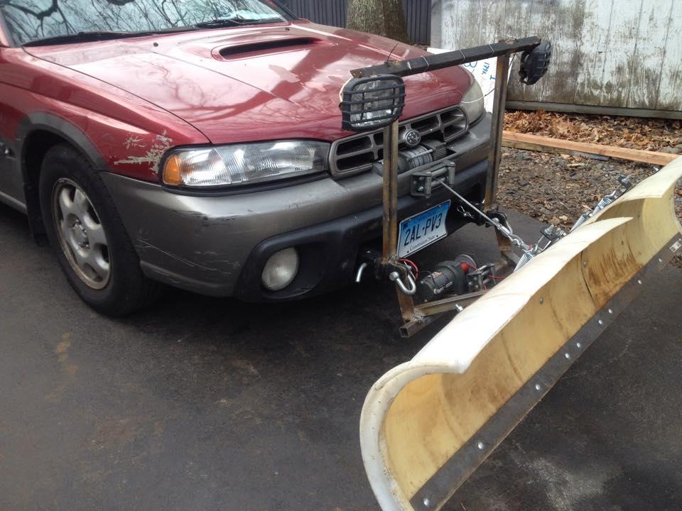

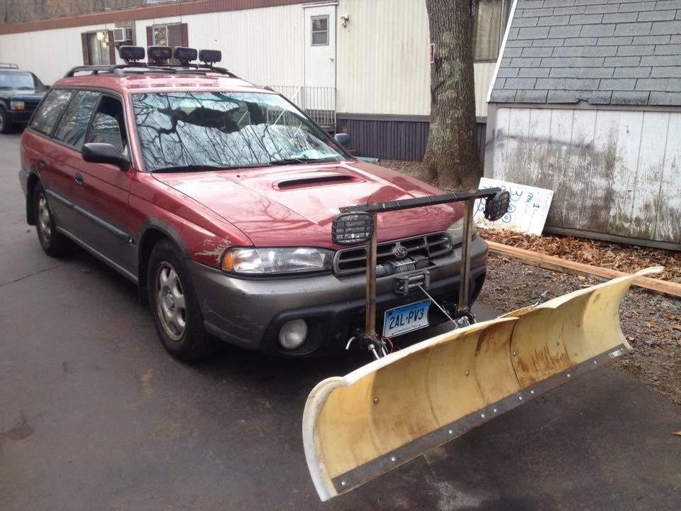

  1. Thats upsetting me the most I rushed to build to beat the season. Now its off the car, waiting for the snow to come

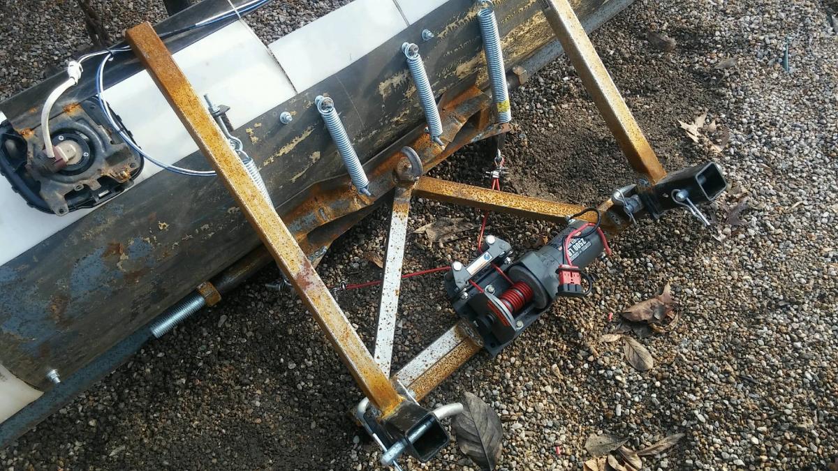

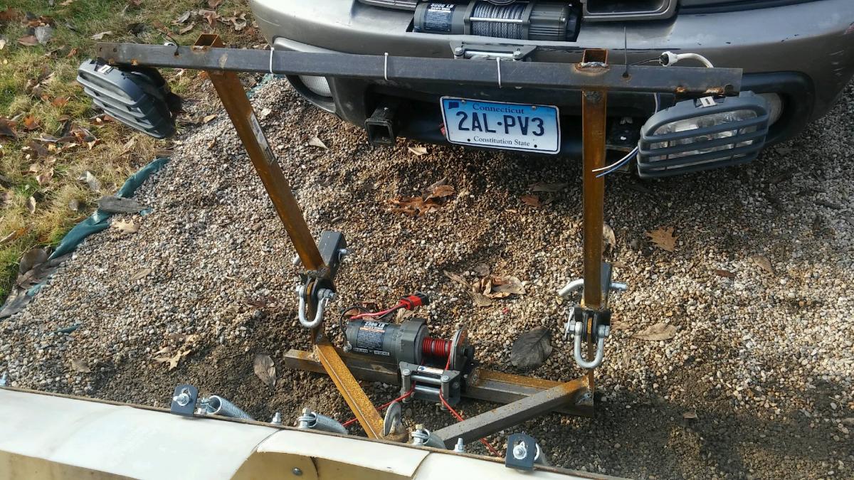

  6. Made from two winches, steel, water heater and 55g plastic drum
