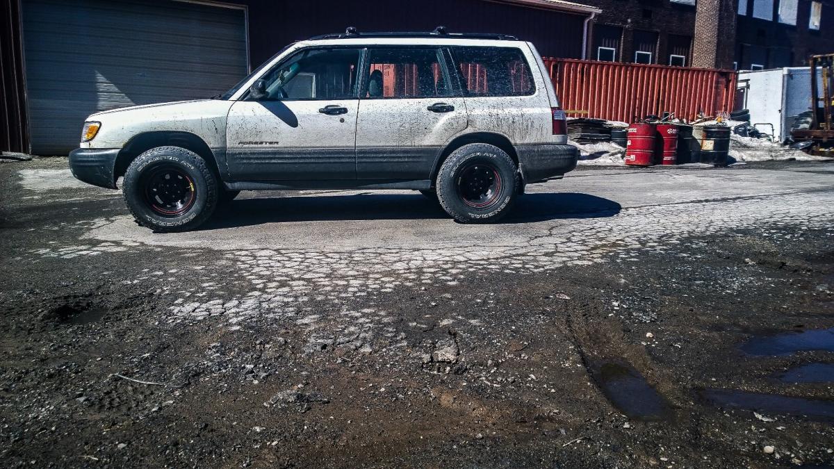

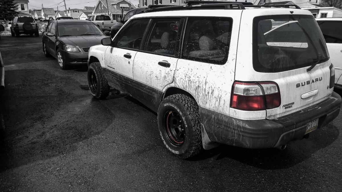

A little update to the fozz. I blew out the coilovers and decided it was time to do what i always wanted to do from the beginning and lift it. So here she is now in all her glory. Parts list for lift: Kyb gr-2 struts Ironman 35mm lift springs Subtlesolutions 1" lift kit Subtlesolutions 2" trailing arm spacer 15x7 -51(2" backspace) basset racing wheels 215/75/15 general grabber a/t 2's
