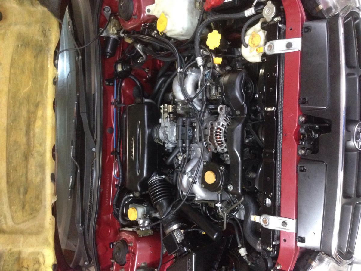

ScottAust replied to ScottAust's topic in 1990 to Present Legacy, Impreza, Outback, Forester, Baja, WRX&WrxSTI, SVXThatt hasn't been cleaned after the swap yet ! Both engine bays were cleaned before the swap so I xould work on them without getting covers in grease and dirt. Being a first timer I wanted the see and feel everything.

Hello all, I have just done the 25 to 22 swap and it was very easy in the end. I have a 98 outback wagon and the donor car was a 95 Liberty ( Legacy ). I had a bit of confusion with the wiring and that was sorted out in a previous post -" EJ25D to EJ22E wiring issues" if you want to check out the background to help me with this question. The 22 is in and runs beautifully once it is warm. When it is cold it is hard to start and takes about 10 seconds of winding over with the starter. Once it does fire it only does about 300 or 400 revs for about 10 seconds then it goes up to normal idle. When it is hot it starts perfectly, it will fire within 1 or 2 seconds on the starter and goes straight to about 1500 revs and then back to idle like it should every time. The other issue is the thermo fans come on as soon as you turn the key on. I don't know if these 2 things are related or maybe they are symptoms pointing to the obvious problem or part that isn't working. As I saod I have only just finished the swap so have only run it in the shed for 15 mins or so a couple of times then test driven it for a few miles the next morning. In the afternoon I ran it and unplugged the fans and let it get to temp then plugged the fans back in and let it run for half an hour. I guess the ECU would not of had time to learn the differences as yet. Both cars were working as normal before the swap and didn't have either issue.

ScottAust replied to ScottAust's topic in 1990 to Present Legacy, Impreza, Outback, Forester, Baja, WRX&WrxSTI, SVXThe swap is done and the 22 is running. Thank you to all that made comments here and in general on this site. Just about everything I needed to know I searched and found the answer. Considering I am not a mechanic, only have basic tools and have never removed an engine by myself before, I am very pleased with myself ! 25 out of the outback, 22 out of the donor, 22 into the outback then put all the right parts strewn around the shed back together, all in 3 days. Just to clarify that- a day being 4 to 6 hours in between other things like kids and other household duties. So 1 day each to strip the motors ready to be pulled. On the third day it took 2 hours to pull both motors and put one back ( amazed myself how easy this actually went) then about 6 hours to put everything back together. Only real problem was I bent the metal cover on the bottom that covers the flywheel etc. And it was touching. So when I started it up it sounded like world war three and frightened the s••• out of me. I was able to undo the engine mounts and Jack it up enought to straighten it out. There are a couple of hiccups which I will start another post for. ( cold start and thermo fans staying on ) when for a short drive and it runs perfectly. Also worth mentioning the 25 had a bad head gasket and seemed tired with 205,000 kms on it. The 22 has only done 80,000 kms and been properly maintained by a Subaru dealer every 5000 kms. I know people say the 22 lakes powerin comparison but not in this case. Maybe just the difference between a good and bad motor ? My message here is if I can do it .... It can't be that hard.
