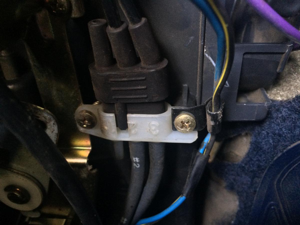

Ok that all makes sense. However I cannot find a cable or a hose lableled number 1 under the dash to goto that connector, I traced the lines to the vac canister and backwards, all lines are hooked in properly that I can find. And all the buttons and vents rotate to there desired position. The a/c also works just fine, I traced the connector from the vac canister up behind the firewall down and through the hole with a rubber gasket, up to the panel on the dash with the control buttons, "def,heat, bi-lev, a/c. Off" and everything seems to be hooked up as it is supposed to be. Everything does its desired function. I am stumped on why there a missing cable and vac hose to and from this connector with 3 spots on, hoses and cables 2 and 3 are present, yet number 1 is not? I appreciate any and all advice! 93 ea82 loyale spfi n/a 1.8 -

Hello, my 93 ea82 loyale spfi has a white vac hose connector labeled 1 2 and 3 under neath the driver side dash, close to heater core, right above the accelerator pedal. There are 3 ports on each side Of the connector labeled 1 2 and 3. Hoses 2 and 3 are present and connected to the right ports, however the port labeled number 1 is empty. Nothing go into it, nothing going out of it. I also cannot seem to find hose number 1 either. Any and all help is appreciated. Here is a picture of what I'm talking about. Rock on fellow Subarus!

Sorry about bad pic quality but in the pic you'll notice the white connector, hoses 2 and 3 are connected on the bottom, no hose on the top spot which is labeled 1
