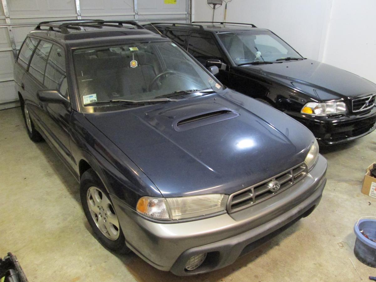

Hello Subaru World I'm Matt and I recently purchased, for $500, this lovely 1998 Legacy Outback. It's got some issues, most I've got squared away. This is my first Subaru and hopefully I'll find some guidance on a few things I need to take care of. So far I like it, I love the versatility of a wagon. Makes a nice pair with my 1998 Volvo V70R wagon. Thanks Matt
