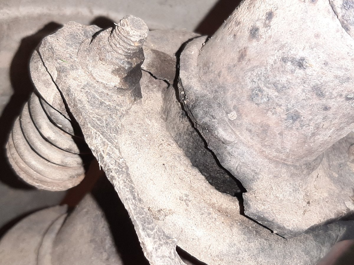

'95 Legacy had a broken exhaust flange by the cat converter. I'm hoping this is replaceable and not welded in. So before I start wrenching, thought I could ask first. Any thoughts? This is my DD and can't have out of service.

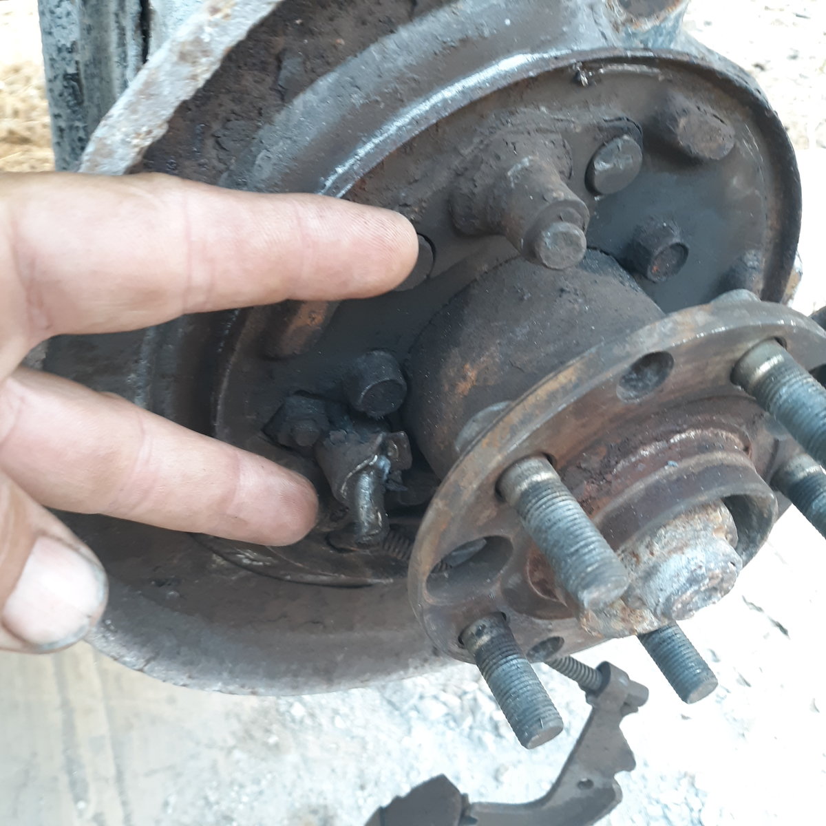

StephenA replied to StephenA's topic in 1990 to Present Legacy, Impreza, Outback, Forester, Baja, WRX&WrxSTI, SVXAdvice time. Is it better to replace the back plate or the entire assembly? You can see in the picture where I'm pointing out the bent areas. Hub? Is that the right word? The 3/4 breaker bar and 32mm socket should arrive today from Amazon.

StephenA replied to StephenA's topic in 1990 to Present Legacy, Impreza, Outback, Forester, Baja, WRX&WrxSTI, SVXTone ring... that's what that's called? Yes, the screws came threw the spindle into the ring. There is no way to rebuild it. It's too beat up. I'll be pulling the assembly from another car. I'll do a complete brake job on this before it's done. The car is going to a lady I know who lives on Social security, and has trouble walking. This ride will give independence and make doctor appointment much easier. So ya, good brakes equals piece of mind. As for the previous owner, I can't say anything bad. He's a nice guy overall. Just a bit clueless. While marijuana is legal in Washington, it doesn't mean everybody should partake.
