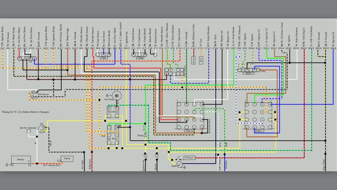

When i look At the wiring in the diagnostic book, the white and the black wire are going directly to the ecu And the 12v middle wire is coming from the ignition relay
