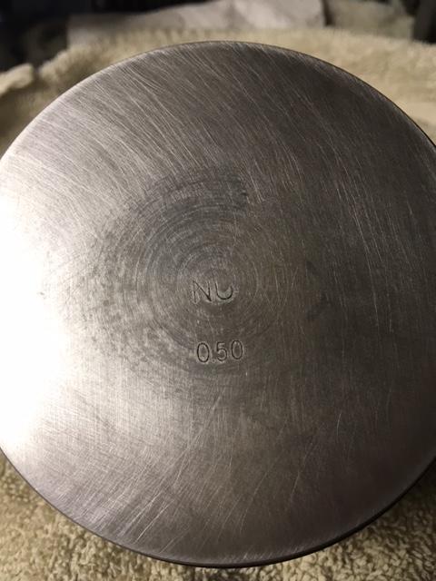

  3. Hello all, I'm trying to rebuild/replace my EA82T and have read on here that the blocks are the same. Hence, some confusion. Below are some pictures. First, a picture of the EA82T block from my 86 GL10: Second, a picture of the block from an 87 XT (non turbo MPFI) engine I bought from a junkyard What is the extra cavity for in the GL10 block? What can I get away with? Third, a picture of one of the pistons from the 87 XT engine. I has been bored 0.5mm over. But this looks like an "interference" design to me and I thought all EA82's were non-interference? Does anyone recognize what these pistons are from? thanks much for looking and providing some help. I hope these pics can be enlarged somehow at least when viewing....
