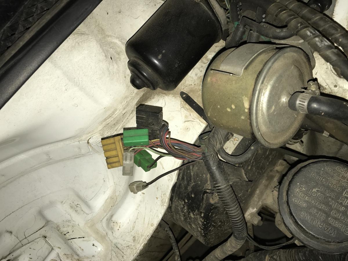

  7. Awesome! Thanks for the info. Just starting tune the car up after driving all winter and was unsure what those wires went to. Currently trying to pin point why my AC clutch will not engage and what cause my heater to blow inconsistent air temperature all winter. Thinking about a coolant system flush and blow out the heater core. Also need to check the AC refrigerant pressure, I think i may be low as the car has never had AC since I bought it and the sensor that in in the plate above the compressor clutch was unbolted when I bought the car. Any other suggestions on tune up maintenance is appreciated. Car had 185k Thank you.
  8. Can anyone tell me what these bundles of wires go to and why are they are not connected to anything? Some thing I have been curious about since I bought the car.
