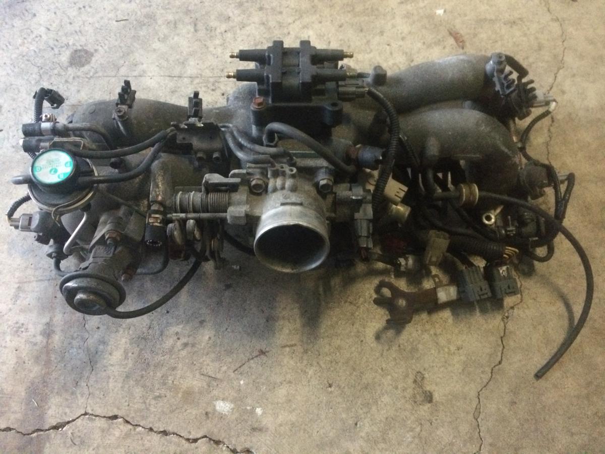

jkast replied to jkast's topic in 1990 to Present Legacy, Impreza, Outback, Forester, Baja, WRX&WrxSTI, SVXOK , I think that will be the plan. I will buy the 2.2 manifold and swap out the parts needed from my friends 2.5 to the new 2.2 . When its complete I will pull the 2.2 without the EGR from the car and install the new 2.2 with EGR and I should be fine. I will let you guys know how I make out when I am done. Thanks for all your help Josh

jkast replied to jkast's topic in 1990 to Present Legacy, Impreza, Outback, Forester, Baja, WRX&WrxSTI, SVXOk so I called Hanna's they will sell me the intake for $75.00 the EGR for $45.00 and he said he would throw in a tube. Would that be all I need ? What about the wiring harness and injectors. Some one also told me I will need to pull the head and have it drilled and taped for some type of connection. You Guys are very helpful but this job is making me nervous.
