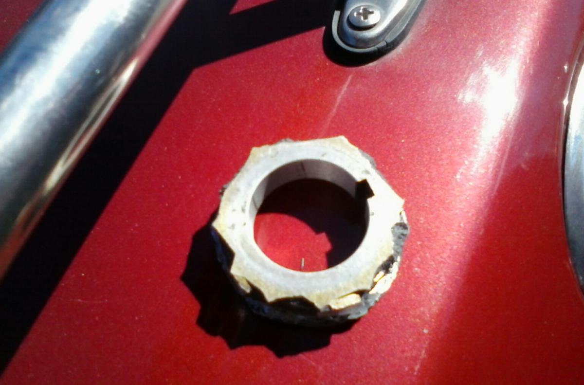

  6. We finally got it out... The dist froze and shredded the gear on the crank... Do I have to pull the motor and split the case to get to it?

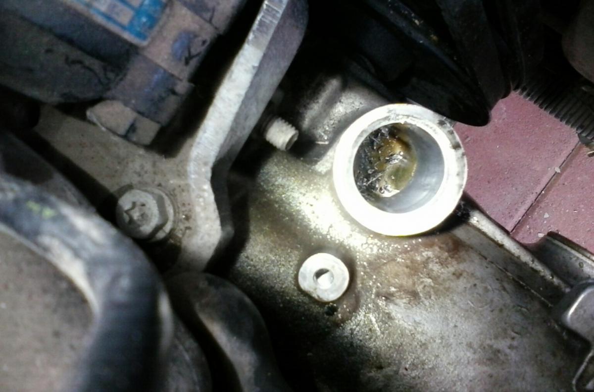

  7. If I remove the plug in the pic can I get access to the gear at the bottom of the shaft?

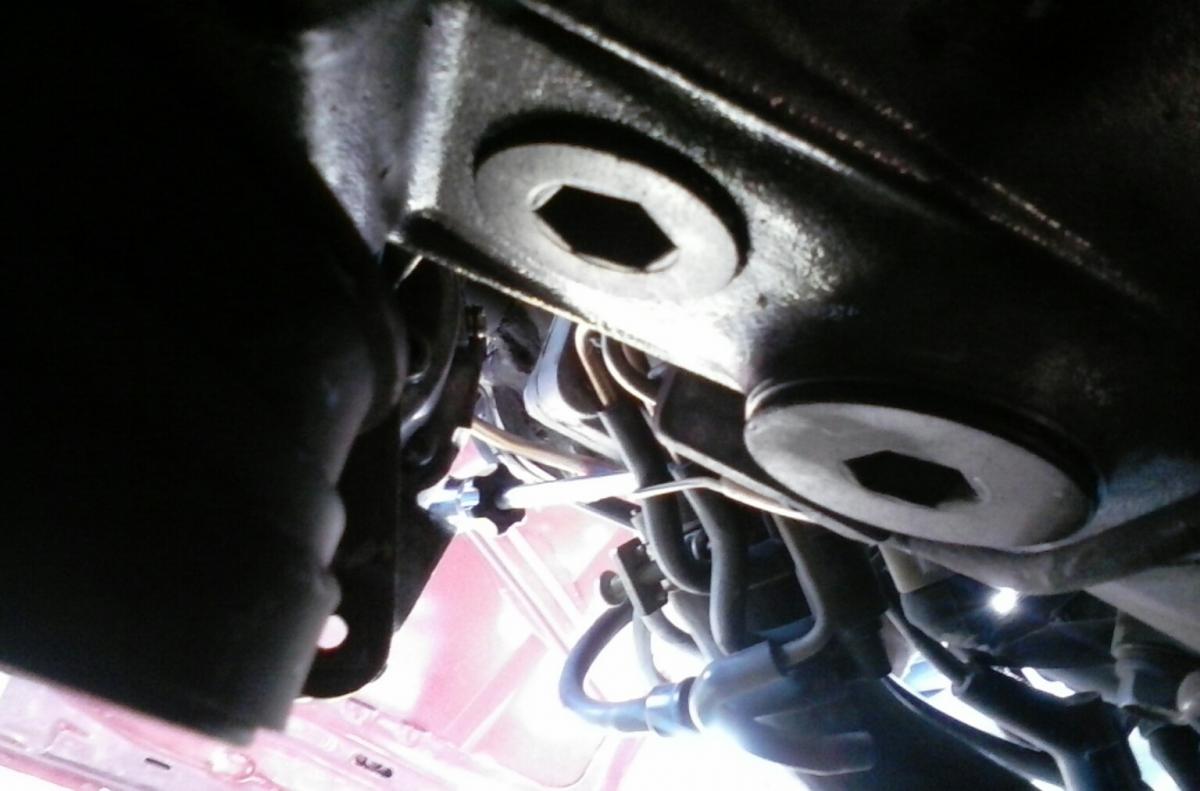

  9. Thanks, I am going to try the slide hammer trick real gently. I wasn't looking forward to dismantling every thing to get to the crank seal. This was just going to be a project and now it sounds like work... Lol
