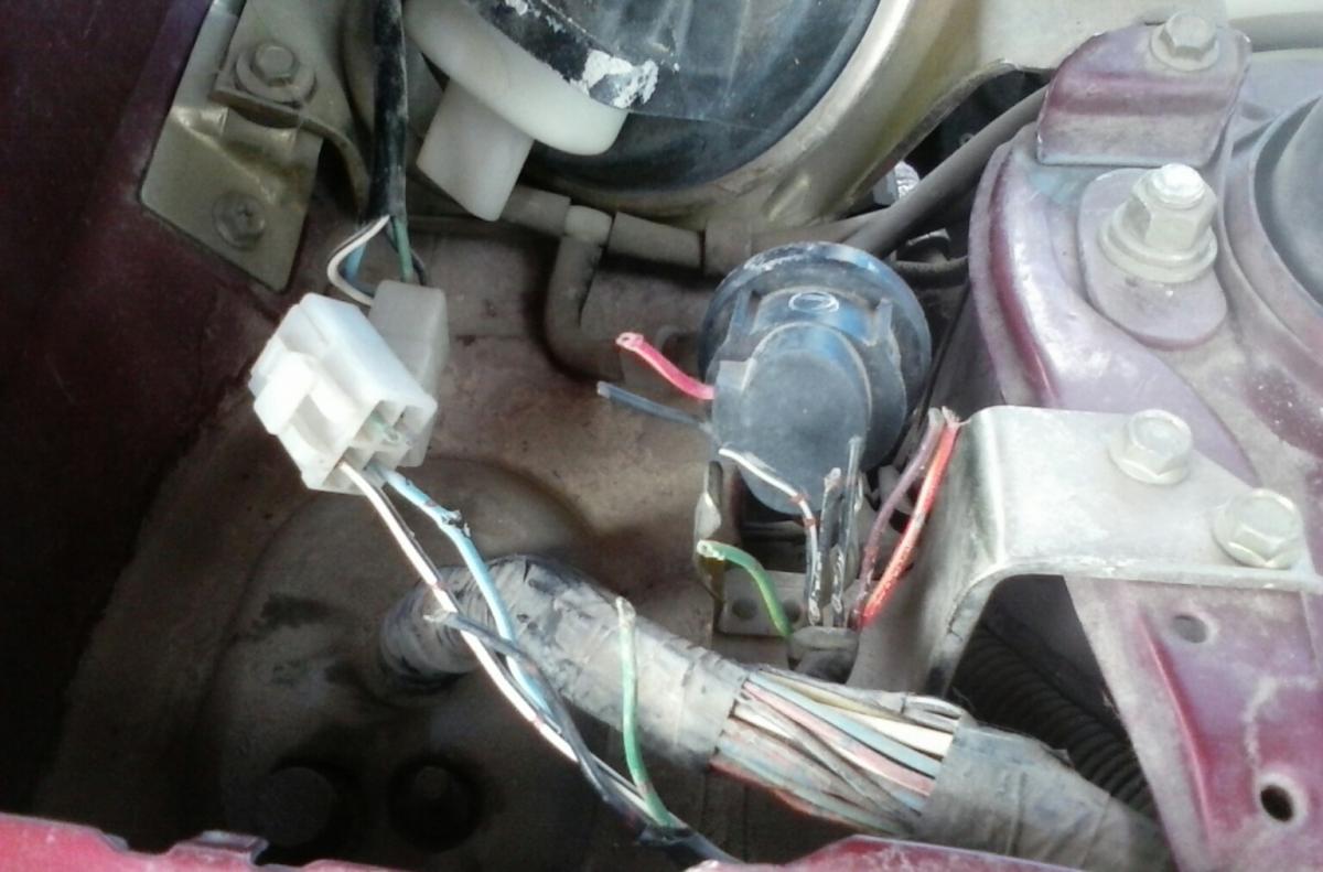

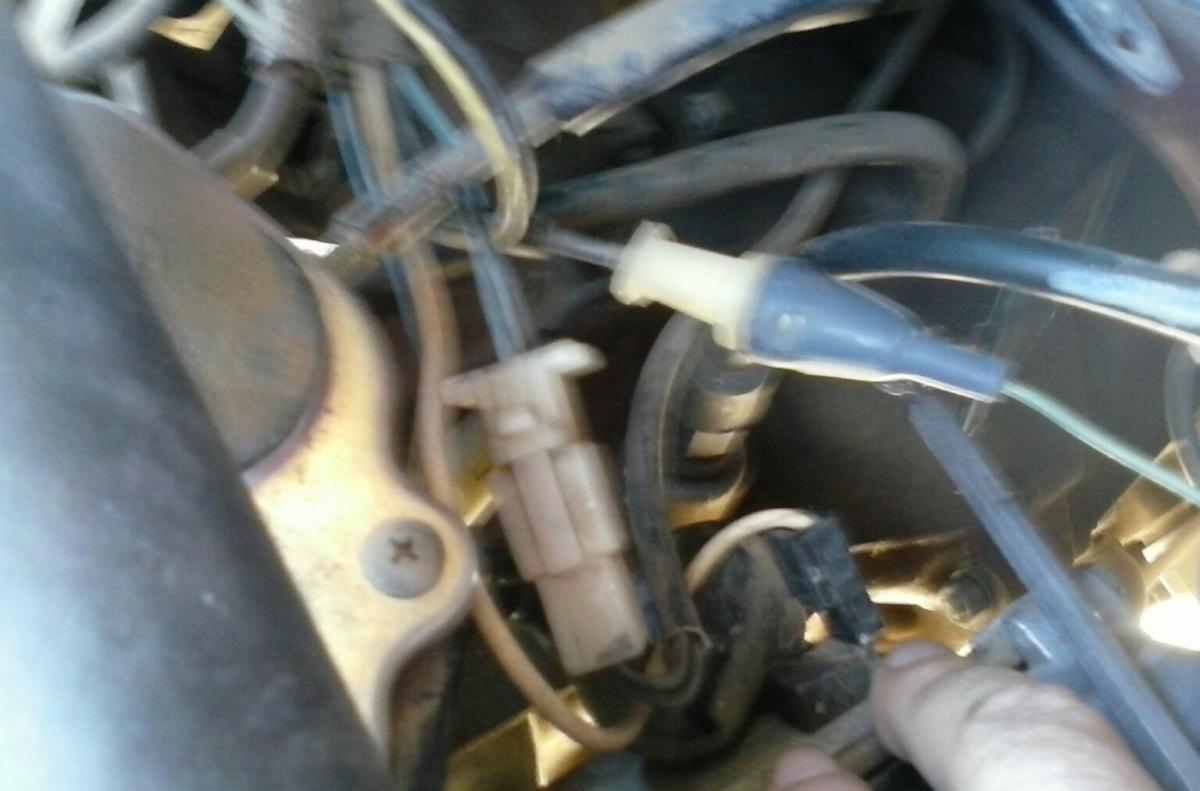

This is the last wire that was chewed up by the killer mouse. It is thick black insulation coming out of the harness with a white plug attaching to a light green wire that is about 10" long where it was chewed. I have searched every diagram I can find and crawled all over the vehicle looking and cannot find where it attaches. It comes out of a harness under the spare tire holder, the fingers in the picture are on the starter for reference. Any help would be greatly appreciated. I guess it would help if I added it's an 84 GL 4wd turbo.
Mystery Wires Need help with 84 GL turbo 4wd
The packrats here are the size of beavers....
Thank you. I have hooked up and repaired the others just those 4 were a mystery. They don't show up on any wiring diagram I have seen. Thanks again.
I am getting my Grandmothers car running that has been in a garage for 17 years and mice have chewed several wires. I am having trouble locating the termination points for several of them. They come out of the harness beside the vacuum valve differential lock and I am sure 2 of them terminate there but I have 4 that I have no idea and have spent hours researching without any answers. The color codes on the remaining wires are GY,BW,BR,B. I am pretty sure the other R and B go to the valve. Thanks in advance.
