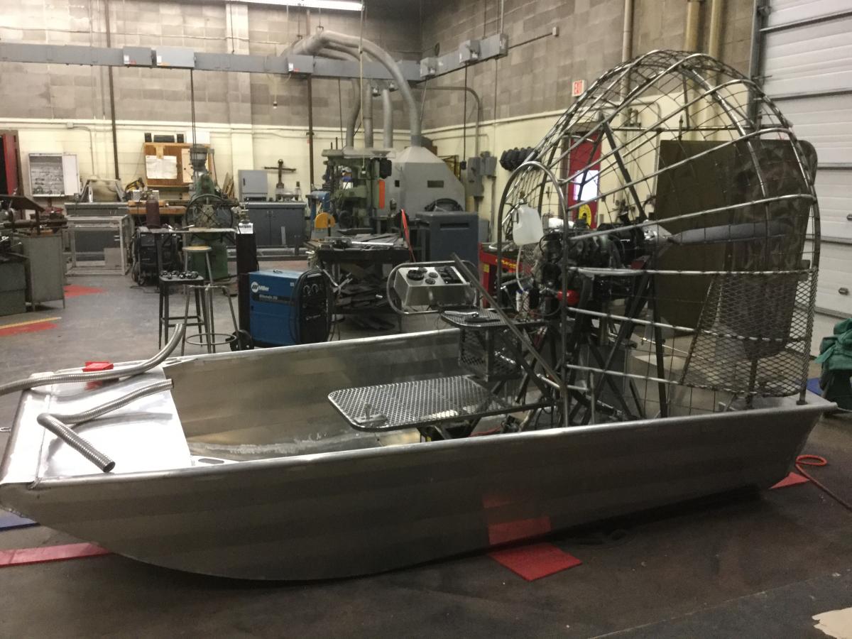

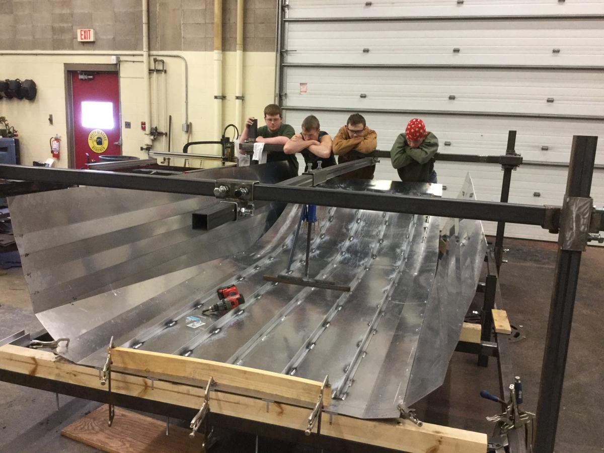

  1. This is the final picture it took me a while to get it to send. Its pretty neat to see what kids can do when they have to work together to make things work. Hope you enjoyed the pictures. Chuck

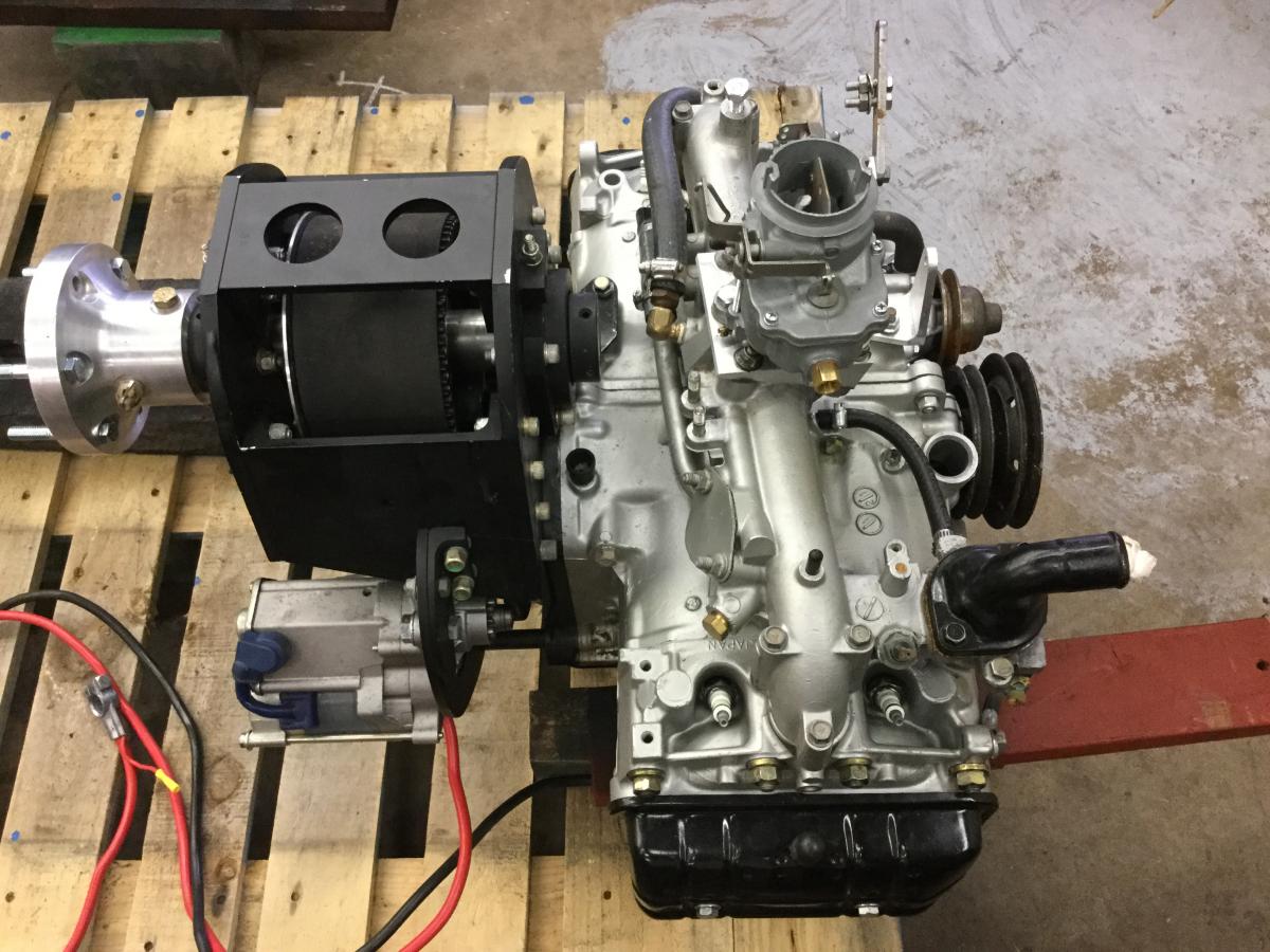

  2. Thank you all for your help. Tore the dizzy apart and put in a new module. Had spark right away, pumped the gas pedal twice and it started right up. I would love to post picture but I am not sure how I can do that on this site. Just so you guys know I understood every word I typed on this topic LOL ( Sorry for the poor description). This engine is suppose to be putting out over 100 HP and we are not there yet. So I will be picking your brains for awhile now if you will let me. Carburetor will be the next part to upgrade. We are running a single barrel chrysler bbs right now going into a ea82 intake. We would like to put a 318 2-barrel carb in but we hear more about the weber 32/36 carb. but we will have to save that for another day. Now that we are back up and running and snow on the way this week I will bring it into school and the kids will all get to drive it on the football field. We also have an EJ 251 engine to rebuild for the next airboat project.

  10. I am new to this forum so thank you for letting me in. I am a Technology and Engineering teacher in a small town in Wisconsin. We do not have an auto program here but we do a few projects with engines. Our last project was an airboat, we built everything; the alum. hull, cage , stand, trailer. We powered the airboat with an EA81 Stratus engine, redrive and warpdrive 3 blade prop. We rebuilt the engine, got it finished and it ran great, no choking on starts it just fired right up and purred like a kitten. Has new plugs (gapped correctly), new wires, new coil, new distributor, new starter solenoid and new battery. Like I said it ran great, so I go to start it on a 60 degree day and it won’t start, tried again and again, then all of a sudden while turning the key back to the run position it starts. Let it run for a 15mins and shut it down. Next day I put a spark light between the spark plug and wire on #1 . Went to start it same thing, no spark (fuel pump is running and is getting fuel when I pump the pedal). Multiple times this happens then out of the blue it starts. We are running a split wire to the coil +. Run position with a resister and a starter wire coming directly from the ignition post on the starter solenoid. I did try a new key switch with the same results. So that you know once this engine starts it runs great and I can shut it off start it up without any problems but if it sits for 3 or 4 hours it becomes the same old thing. Could this be a problem with the coil, maybe the ignition module in the dizzy or just a grounding problem ( we have retraced ever wire multiple times. Tested the coil today zero on primary, 9.560 on secondary Any help would be greatly appreciated Thank you Chuck
