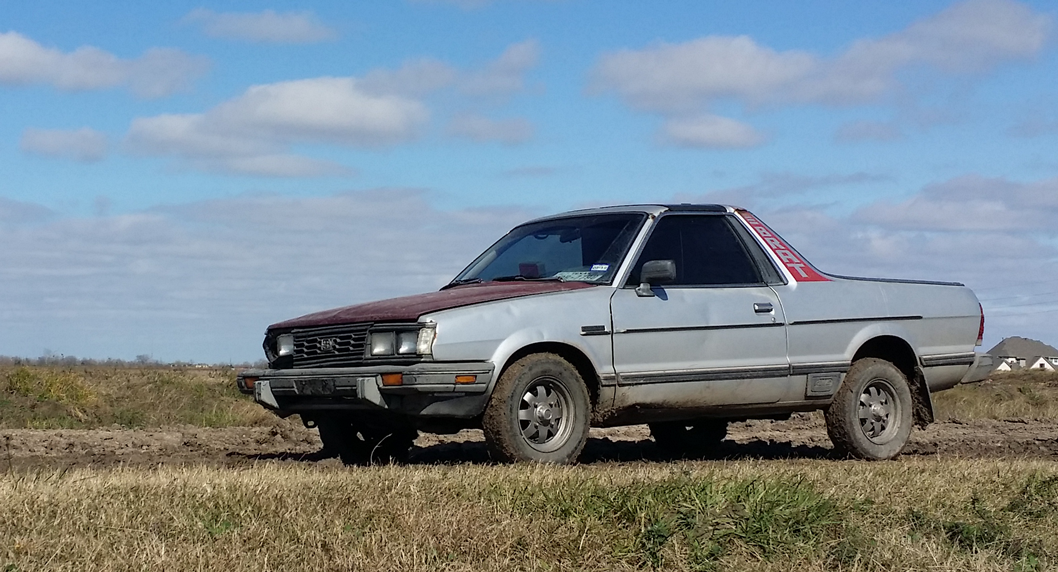

  1. Mine is missing an eye. But I still love it.

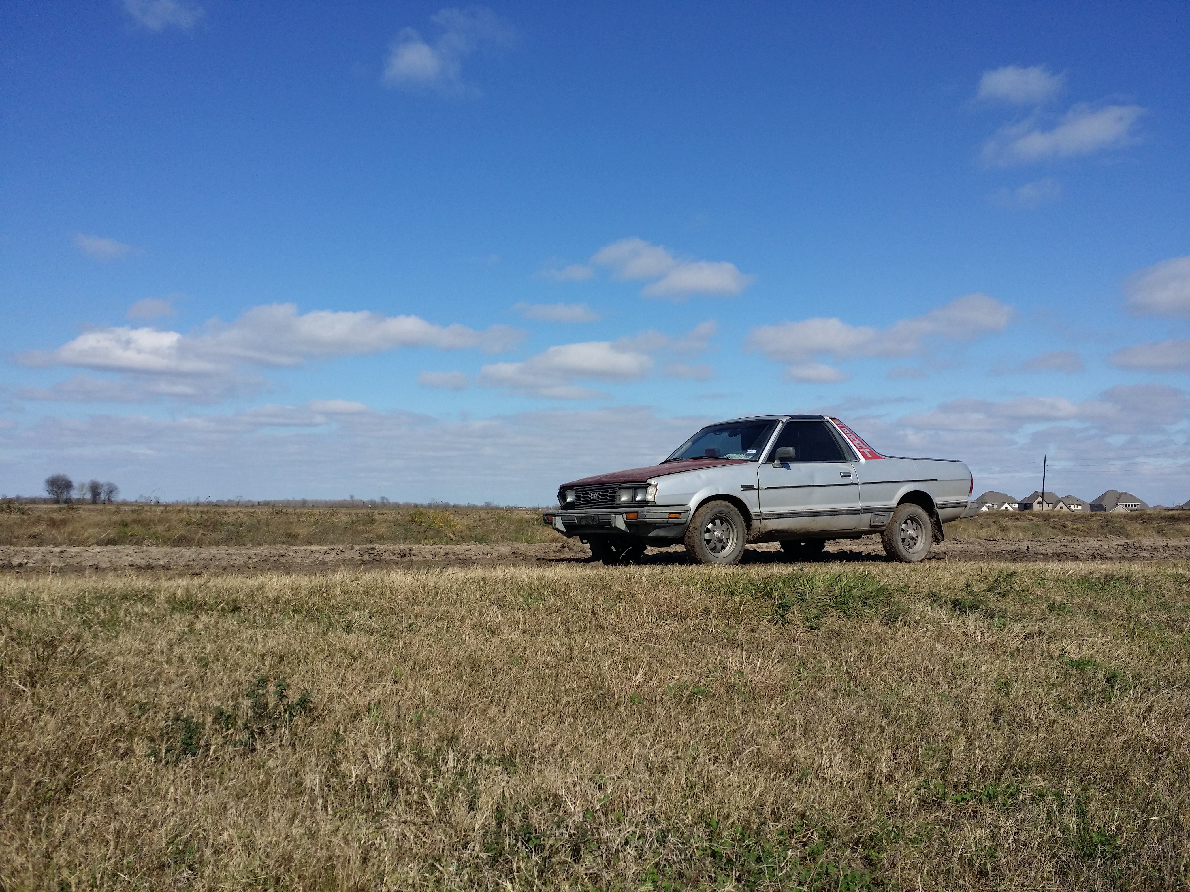

  3. I have a 1985 with 179k miles on the clock, got it about 2k miles ago. From the looks of it, about 95% was original when I got it (mostly for worse). It seems that every part I change is original too.
