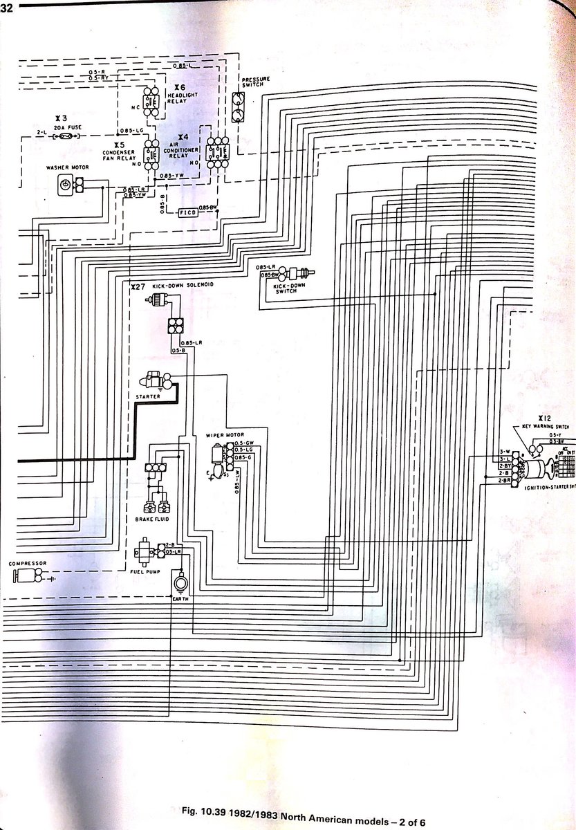

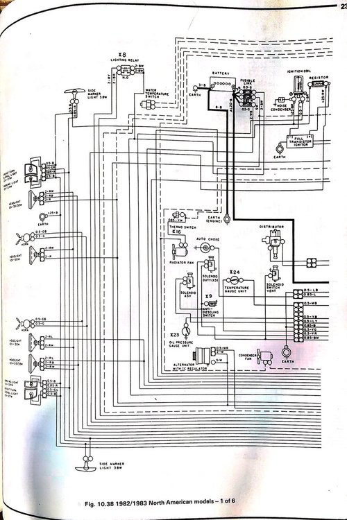

Whoops! Completely forgot to put year, and model. It's a 1982 GL Wagon. It's really in pretty terrible shape but the engine fired right up once I got the fuel pump working. I've looked around a little for a factory service manual, but haven't had too much luck. I'll keep looking the interwebs for them though. Couldn't be that difficult, right? For now, this is the Wiring diagram I've been trying to work from....
Hey everybody! I've tried to do my due diligence to track down this little wiring gremlin I've been dealing with, but I think I'm finally to the point of requiring help as my searches have led me to a dead end. Got this car for $200 and have been slowly going through it bit by bit and I think the final issue I'm running into is that the electric fans don't work. The A/C fan is shot entirely so no surprise why that one doesn't turn on, but wiring up the passenger side shrouded fan to 12v shows that the fan will indeed run, my issue is that I've got no power to the positive terminal of the fan connector next to the radiator. (somebody has obviously run into this issue before because whoever the previous owner was ran a toggle switch to a permanent 12v.) Possibly explains why it's needed a headgasket before too, but I digress.... I'm trying to track down where the voltage is being lost as from what I can tell in the wiring diagram of my Haynes manual, the fan receives power from the battery, through a fusible link on the passenger strut tower, and then through a 'headlight relay' directly to the fan motor, which then grounds through the radiator via a thermo switch. Is that correct? From my interpretation of this shoddy diagram, it looks like the fan should have constant voltage with the ignition turned on, and I have voltage on both sides of the fusible link, but I do now know which relay is the headlight relay. I do know that the headlights work without issue, but I suppose it could always be a double pole relay and one side is not working properly. If anybody can tell me which relay to look for and which wires to trace or other components that could be causing this, it would be greatly appreciated! Thanks guys!
