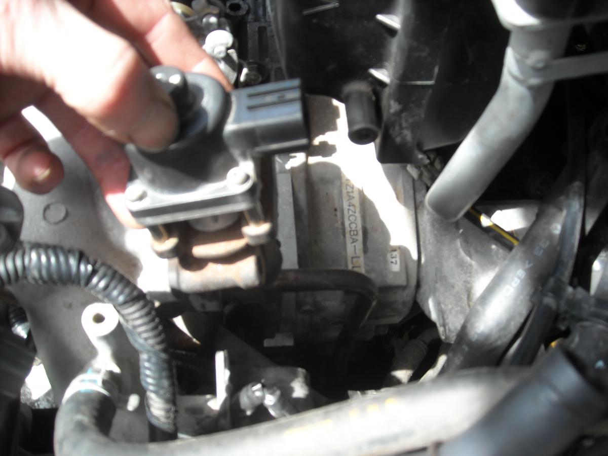

EGR issues
LEOD replied to LEOD's topic in 1990 to Present Legacy, Impreza, Outback, Forester, Baja, WRX&WrxSTI, SVXI pulled the y header off, tig welded a 3/8 flare fitting on it and on the end of cut off pipe ( first time using my tig welder and I didn't screw it up, a new era has begun) and put an appliance natural gas line on it, one of those stiff yet flexible stainless ones. It snaked through there just fine and stayed where I put it. Just knowing for sure what the situation was made all the difference, Thank you again, SSI gets a stellar yelp review. Now for three road trips, and the dreaded DEQ.

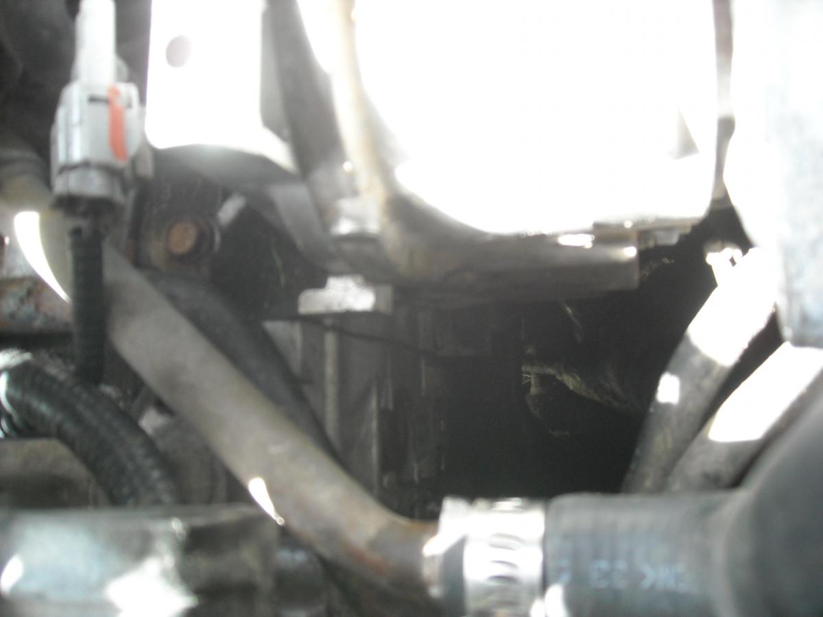

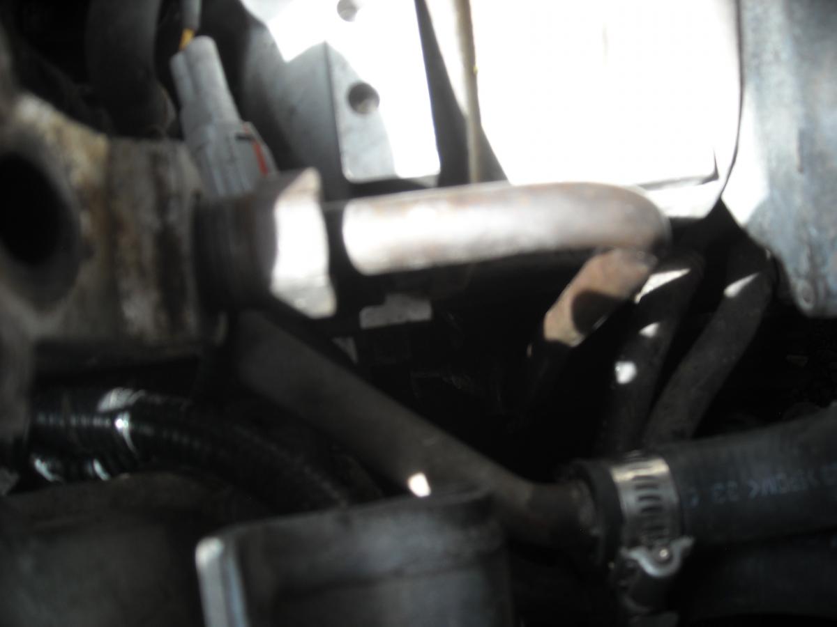

EGR issues
LEOD replied to LEOD's topic in 1990 to Present Legacy, Impreza, Outback, Forester, Baja, WRX&WrxSTI, SVXThank you very much, my brain was having overheating issues. At least now I have it nailed down and can concentrate on the how, and not the why. Even though it was a swapped head as I feared, basically worst case scenario, I know what I have to do, drill a hole in a perfectly good exhaust system for an exhaust gas source, plumb it to manifold without ANY leaks without blowing my ecm with a tig welder, no problem . HMMM Some cats have extra o2 sensor holes, maybe I will get lucky and find one.
EGR issues
I have a 2004 outback with a 2.5 I just bought, DEQ time. I had to reset an egr code so when I went to go through DEQ it did not pass, "not ready". Which means you must go through several driving cycles, including over 55 mph trips, at which point the egr code pops up again. Not cool when you have 7 days left on your second and final trip permit for the year. Upon inspection, i found the EGR tube at the bottom had been cut and crimped. Okay, buy a new egr tube and hook it back up, right? For the life of me, I cannot find where the bottom goes, nor have manuals or utube been any help. The only spot I see on the head is the plug for the coolant, and a aprox 10mm dia. x 25mm deep blind hole right beneath it. Did someone swap out a head? non egr? Help me , please. here is pic of tube to nowhere, egr valve and back of head
