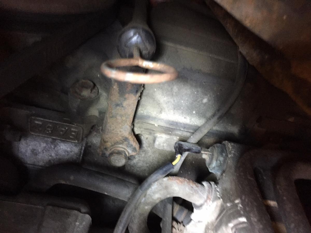

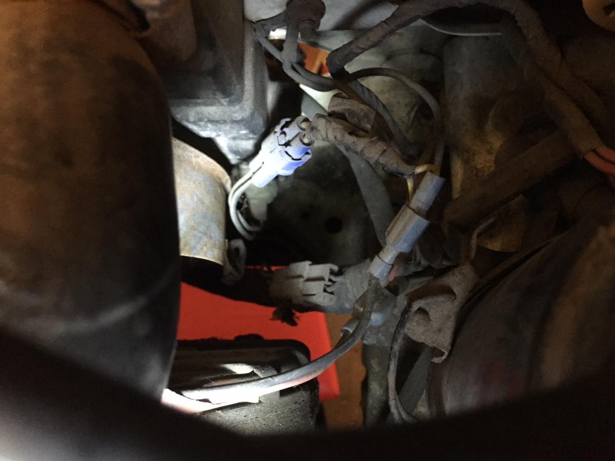

So I've been doing some trouble shooting with my high idle issue with a GL-10 turbo. From everything I've seen on the form it looks like the CTS is the culprit and do to time line I've already got it on order. So when looking at the thermostat there is only a 1 wire sensor at the bottom of that. The only 2 wire sensor I was able to locate is a third of the way down the rad on the passenger side. The connector looks to be the same as what I'm searching out. one of the wires is in series with the A/C fan though which tells me this is switch rather than a sensor. The only replacement vids I've been able to find are N/A models and have the two wire sensor under the thermostat which does not match what I'm looking at. Attached some photos of what I'm looking at.
