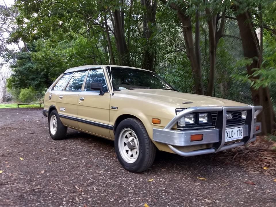

So I replaced the rotor and cap, went for a drive and it konked out and wouldn't start again. So ruled those 2 things out.
Seems to be when the engine is warm that it won't start/runs into problems.
This morning I've replaced the module, so hopefully that works. Started fine once I replaced it and I will go for a drive soon. Odd thing is, that the one I took out seemed to be quite new which makes me a bit nervous. I suppose it could still be faulty, but just seems a bit unlikely to me.
Anyway, hopefully this new module will do the trick as it set me back $100 AUD. Better than a whole new dizzy I suppose, which would be in the hundreds around here.
