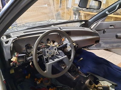

  23. Hi all, I am hoping to wrap up a major step of my EJ22 swap this weekend and just had a couple questions that I was hoping someone could answer. I found some answers from the search but not exact for my situation. The donor car is a 1996 Subaru Legacy Outback 2.2L Harness was wrapped and prepared by SJR Receiving car is a 1987 Subaru RX I have already got the car to run and drive, I am just in the process of getting the gauge sorted and all the wiring routed in their final positions. 1) My speedometer is mechanical, Do I need this wire labeled 'Speed' and which 1987' wire am I looking to tap? 2) I have two wires labeled 'Rad Fan', are each of these a ground reference for the relay? As in, can I wire each to trigger two separate relays for two fans? 3) I have read on here that the Neutral wire is irrelevant for manual transmission cars, just wanted to confirm I leave this one alone. Any help is greatly appreciated. I have a 4.5 day weekend coming up and I am hoping to make some big progress on the project.
  24. Yeah the lesson I have learned from this is that I should have just started with a puller. I tried heat, hammers and penetrating fluid. Bought a puller set for 27 bucks and should be here by the weekend. Thanks all for the input.
