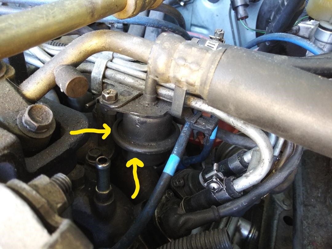

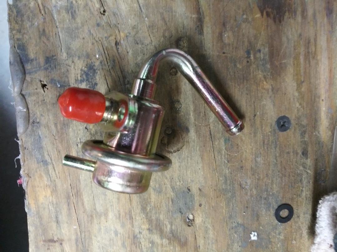

  1. I ordered for 86 XT 1.8. I wanted to make sure I'm taking out the right part, since it's buried under there. Thank you.
  2. Is the first picture the fuel pressure regulator? The 2nd picture is what I received from RockAuto, it's a bit smaller. Thanks for your help. Tim

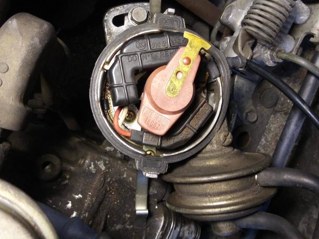

  4. You're right, there's an electrical wire. Here's a picture of the distributor with the flywheel at 0 degrees.
  5. Sorry I didn't see your EGR post. Thanks for that. I have not checked EGR and PCV tubes. I'll give that a try. The distributor does not have an electrical connection, but it does have 2 vacuum lines going to it.
