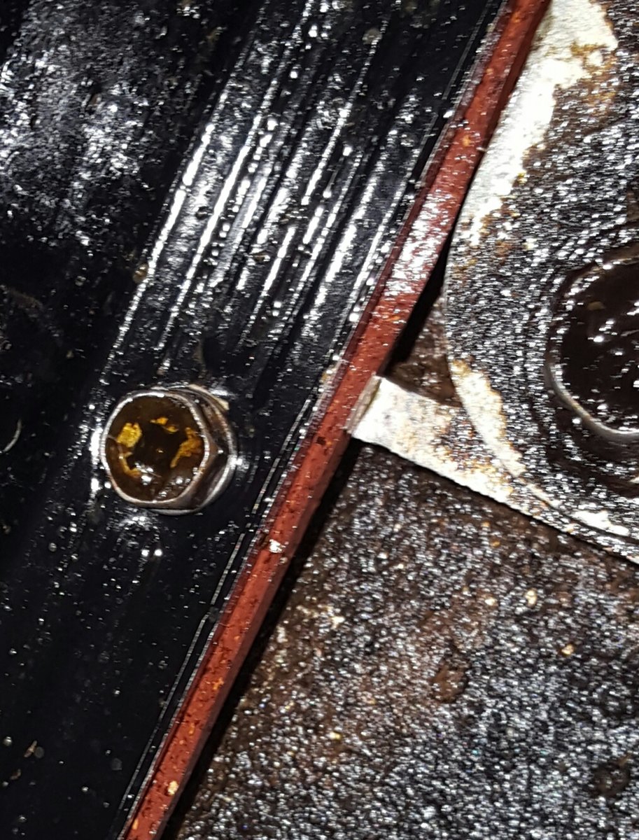

Update or sorts: Got under it, all bolts on oil pan were loose, expecially back ones under crossmember. Changed back to original PCV from the crappie Chinese one I had put in it before. Seems the oil possible ruined my alternator, so if anyone has any ideas you clean that up, I would much appreciate that. I'll be driving it tomorrow after I put in the extra one I have, so I can see if I made a difference. One more thing. Is there any diagram for the 1981 brat vacuum and fuel lines around. The hood on my brat is from my parts car and is a 1980 diagram, same on my 1980 wagon. Thank you.
I actually have both oil sensors. Car came with a gauge sensor attached to the single light indicator. Bought a small sensor type like you have a picture of and installed that. Crawling under the car I noticed fresh oil coming down. Only a drip though. To me this would suggest maybe not a crank seal, but I'm no expert. It had dripped off the passenger side of the oil pan gasket. Also, my oil pump seems to be one of the least affected things on the car, as the seem where it connects to the engine has little to no oil on it. Whereas the oil pan bolts have fresh oil on them. It's hard to tell exactly where it would be coming from, as the fan belt shot the oil everywhere. The back of the crossmember seems to be the most oil covered, second only to the pan. This is assume is do to the placement and flow down of the oil. There is however a small bulge up on the passenger side of the oil pan gasket where the fresh oil had been spotted.
So recently my '81 Brat has developed a very large oil leak. About 2 months ago I replaced the head gaskets, oil pan gasket, valve cover gaskets, PCV, and oil pump/filter gasket. Drove my car a couple hundred miles after then one day I drove it 20 miles, stopped and oil was coming out the bottom and all over the engine like no other. I topped off the oil, and drove it till I got around to replacing the improperly installed oil pan gasket, drove it 20 more miles and low and behold, OIL. The bock, bottom of my Brat and everything is just oil. No clue where its coming from. I had blamed my last gasket problem on the PVC freezing, as I live in the cold hell that is South Dakota. My question is what do you guys think it could be? Is it still the oil pan? Before I had changed the head gaskets I had no problem with oil, only antifreeze. Thank you.
