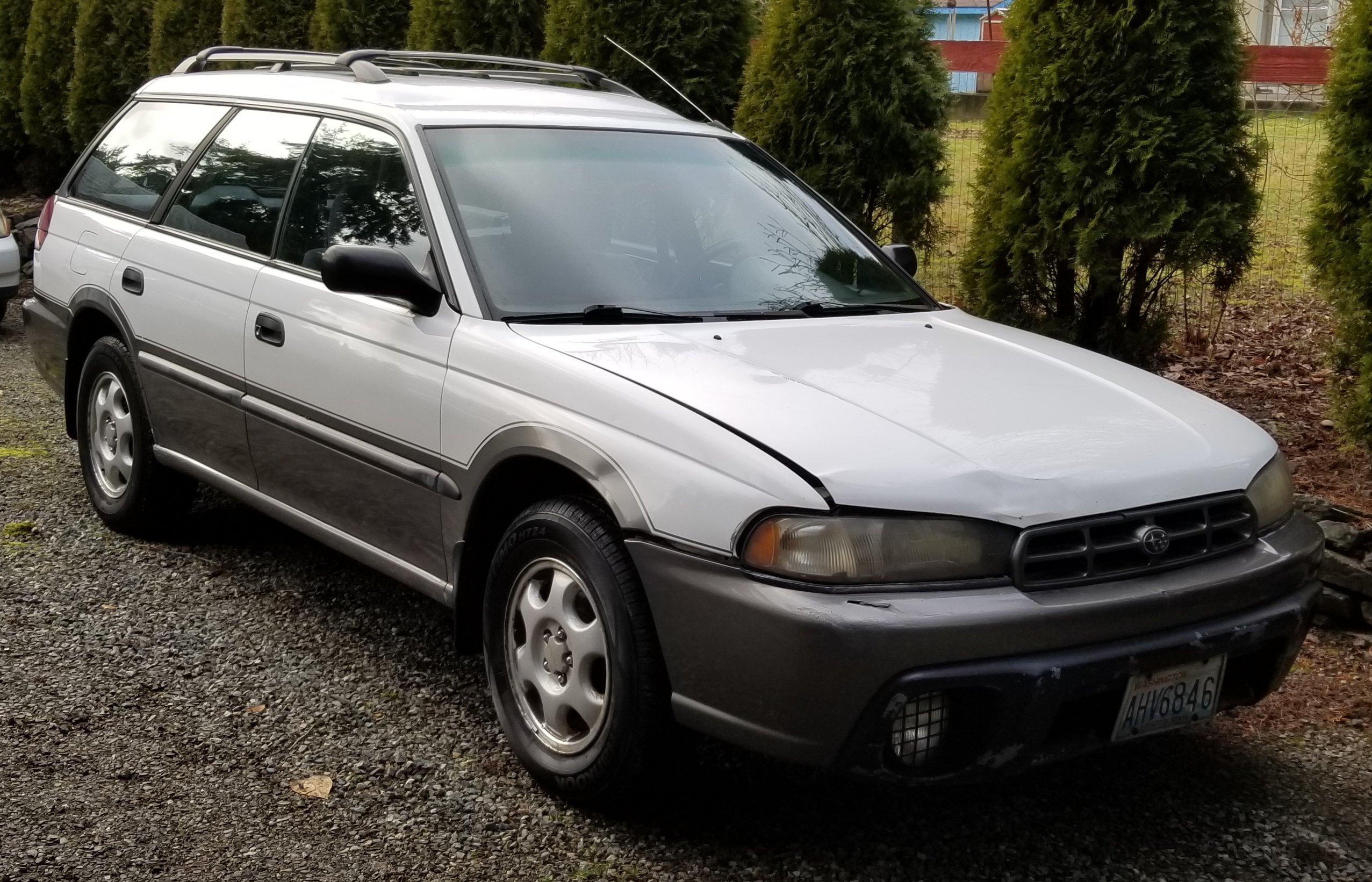

1996 Subaru Legacy Outback 2.2L, 320,000 miles and running strong.Trying to narrow down a coolant loss issue. I've searched and searched every forum I could find on google for majority of the day. New radiator. (Installed by previous owner)Replaced the radiator cap yesterday. Appears to be holding pressure when I use the relief valve. UPDATE: Frothy stuff in reservoir is gone. (Ordered a blown head gasket kit to test) I can see the coolant circulating when I rev the engine by hand and by looking into the radiator.No milky oil on the dip stick.UPDATE: Engine temp ramps to overheat level then back to normal, back and forth while driving. Fans kick on like normal.UPDATE: Loosing heat in cab, then comes back. Upper hose hot with air. Lower hose is cold. UPDATE: Fixed by flipping the tubeAround the radiator cap and overflow area, it seams to be loosing coolant and steaming up. Can't see any visible leaks, but the steam and slight coolant is there. Only steams from the cap and res area. No coolant smell from the exhaust. (I've seen major head gasket leaks on other rigs)FIXED SEE ABOVE: Other than pulling the hoses and res out, I'm at a loss. Never owned a Subaru, but I'm getting a huge education on their quirks. So yes, I'm a new member. Planned on using the Subaru as my commuter car cause tossing over $100 a week in fuel into my Dodge is getting old, not to mention I'm an owner/operator of my own semi so my fuel bill is outrageous as it is.Any help would be appreciated.
