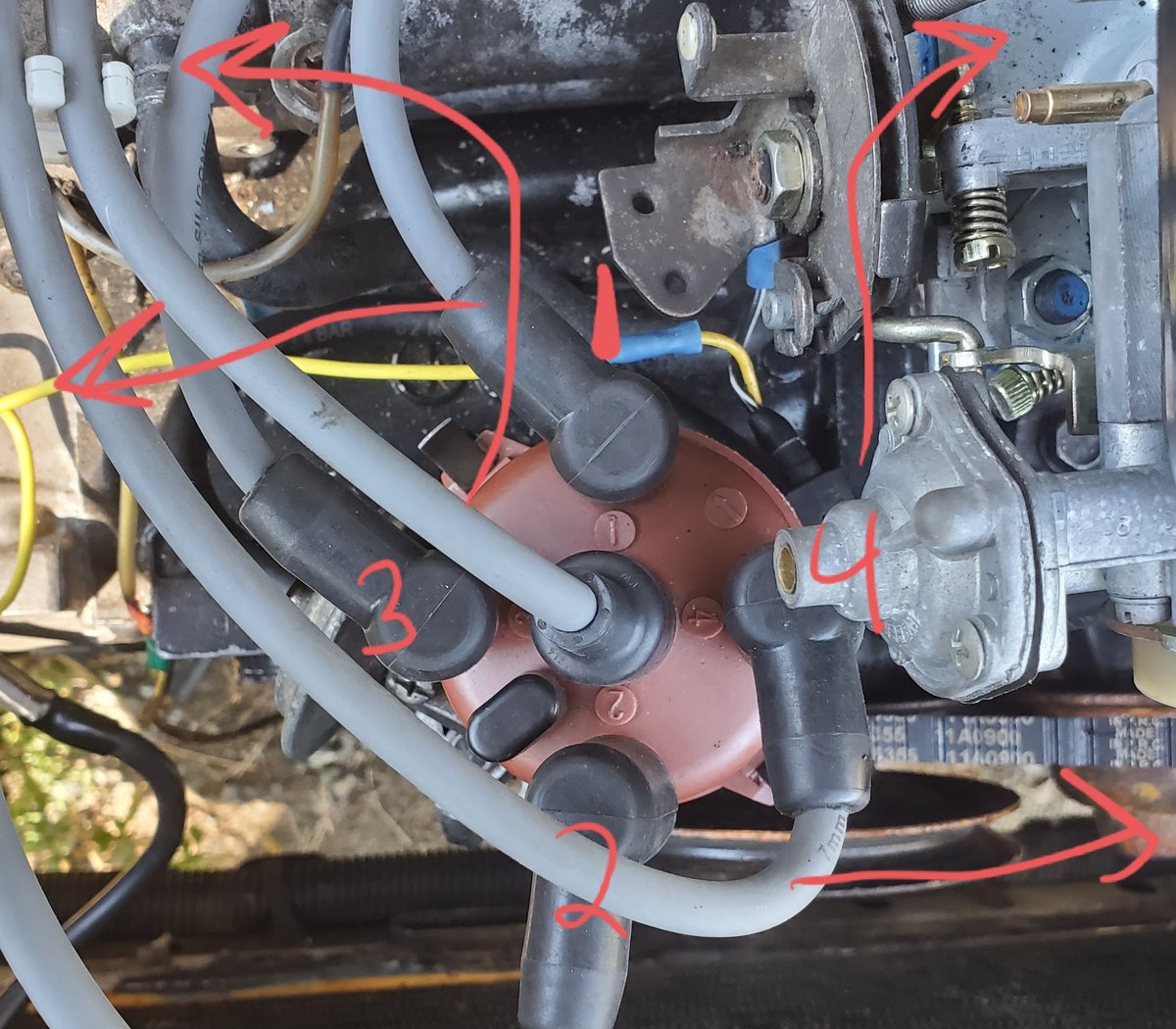

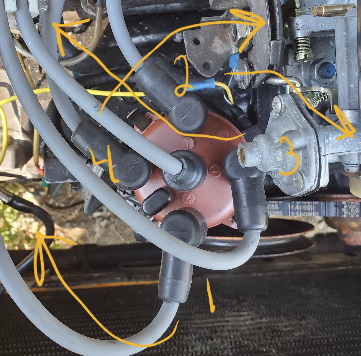

SOLVED. Dear mother mary and sweet lord baby jesus we got her to fire. It was the disty out 180⁰ The funny part is, the distributor cap is labeled with number denominations saying "1-2-3-4" and I wired them to the corresponding cylinders. The numbers labeled on the cap were off. I am attaching photos of what had me stumped for nearly 2 months. The yellow is the correct wiring. The red is the 180⁰ out. -

It took me a while to even summon up the courage to be humbled/humiliated by everyone publicly when they hear I found the solution... Every day after working in a 110⁰ printing shop (where I am the owner and as any business owner is well aware, it is a STRESS FACTORY), I would come home to tend to my delicate steed, the 1984 subaru gl wagon 4wd. And hey, cut me some slack, Im only 23... lol. The diagnosis was, no power to the dash, and no fuel delivery. After swapping the stock hitachi carb for the weber dgv 32/36 and following the instructions to the best of my ability, I proceeded to replace the fuel pump as well. I lost dash power right after the terminal (unsure of color) popped off my IG switch and made contact with another terminal. I checked all the fuses (or so I thought). Another week went by and I trudged myself back over to my nightmare vehicle just to find a fuse HAD blown. Despite the frustration with myself, it was a HOORAY moment. Dash power is back. But still no fuel... I checked power the FPCU, I checked power to the Fuel Pump, I checked power to Neg lead of IG coil on crank, all good.. SO WTF. So after countless hours scrolling through forums, reaping the internet, flipping through my haynes manual endlessly (and slamming it shut a few times) it was my dad who found the solution. My dad hates working on cars. He has refused to give more than 15 minutes of input every time I ask for help. But he asked me.... if the fuel pump.... was pumping the right direction..... "OH MY GOD, ITS NOT" I thought. After 15 minutes out here on this fine Oregon morning and we have power and fuel delivery once more. I know the idle speed screw, timing, timing advance vac, and fuel mixture will all be the antagonists for today but we are 1 step closer to getting her back on the road. Thanks for reading and feel free to dig in, you wont hurt my feelings. haha. -
