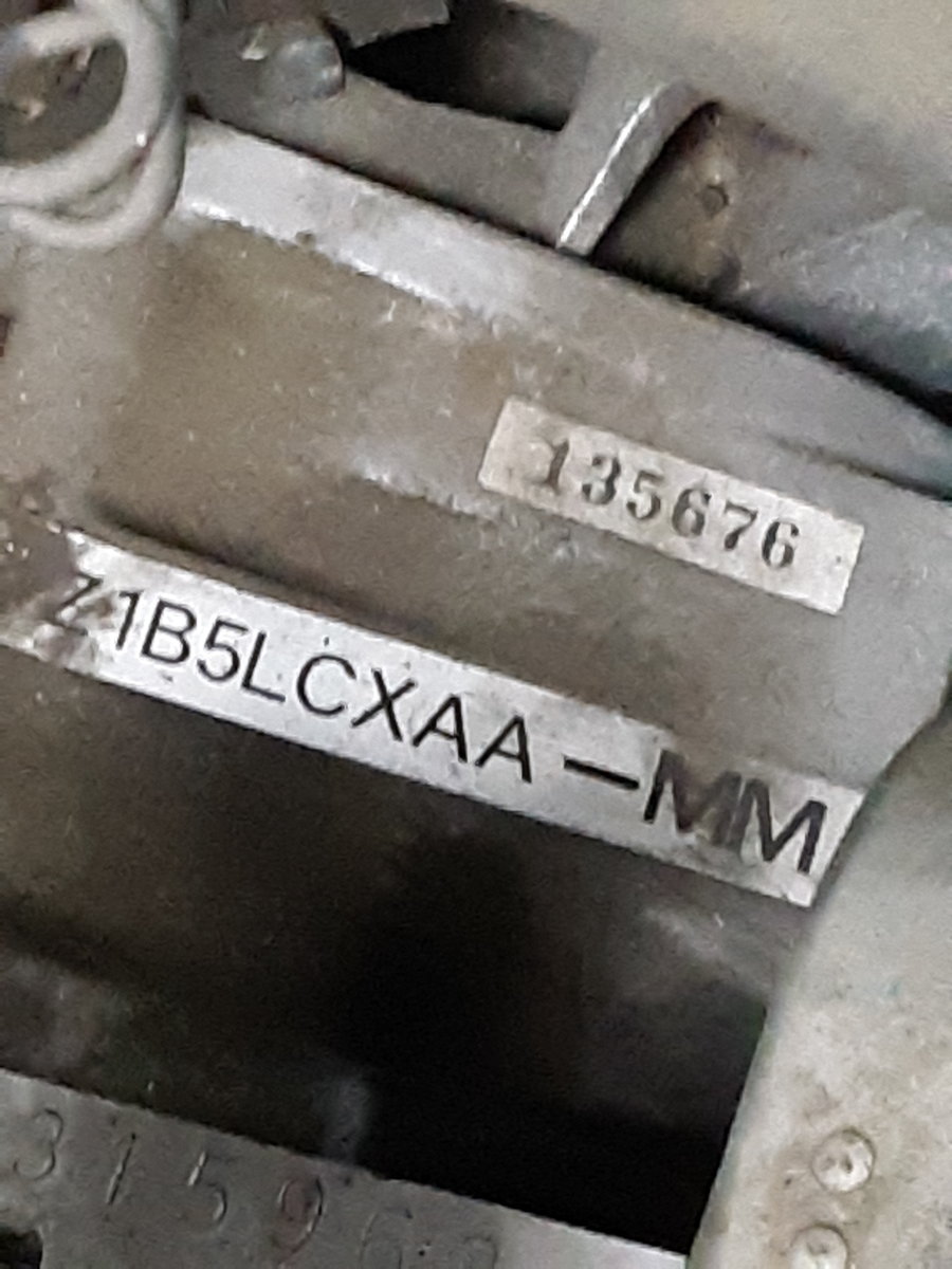

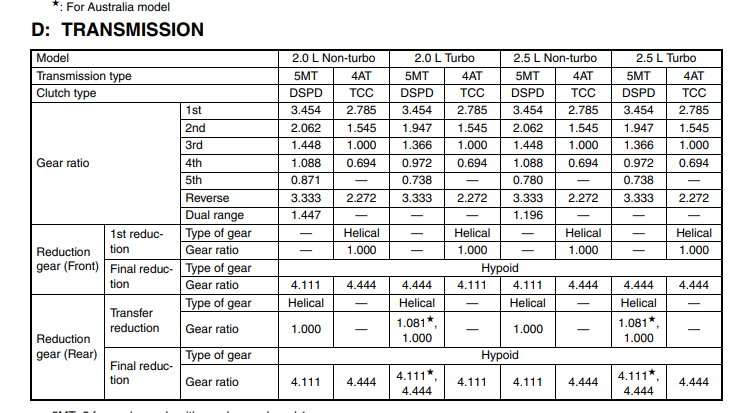

4Flats replied to 4Flats's topic in 1990 to Present Legacy, Impreza, Outback, Forester, Baja, WRX&WrxSTI, SVXLooking at the 2005 manual listed above... That's not my transmission... Could there be Frankenstein mechanics going on here?

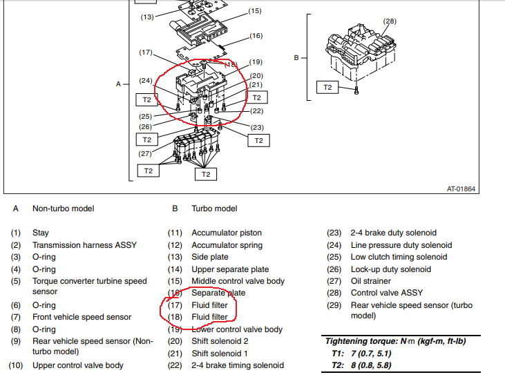

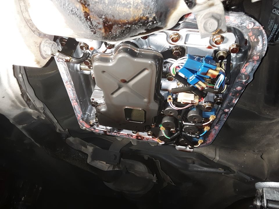

4Flats replied to 4Flats's topic in 1990 to Present Legacy, Impreza, Outback, Forester, Baja, WRX&WrxSTI, SVXIt is probably worn out but (EDIT) 3 oddball issues: I dropped the pan and did a full service, spin on filter and screen. The fluid was nasty and the filter had been on there a while. But It still seems to shift fine. The filter screen was a 3 bolt but the Napa computer and the O'Rileys computer said the transmission should have the 16 bolt (or so) screen. Is is it possible this transmission in incorrect for the vehicle? How do I identify the transmission type? The other odd ball thing, could worn front tires cause this? The fronts are out of line and bald on the inside. Rears look pretty good. There is an oil cooler above the filter, from my other post that is odd for a NA motor in the US?

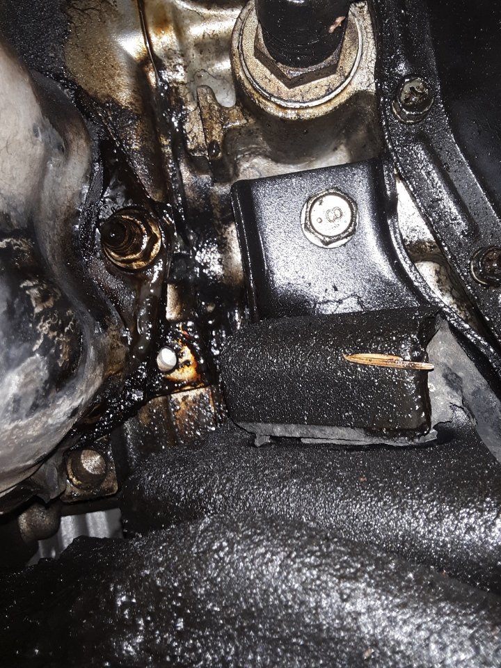

4Flats replied to 4Flats's topic in 1990 to Present Legacy, Impreza, Outback, Forester, Baja, WRX&WrxSTI, SVXThanks for the info. This is a different animal than what I usually tinker with.

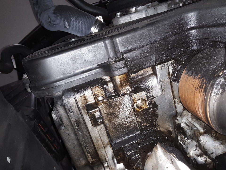

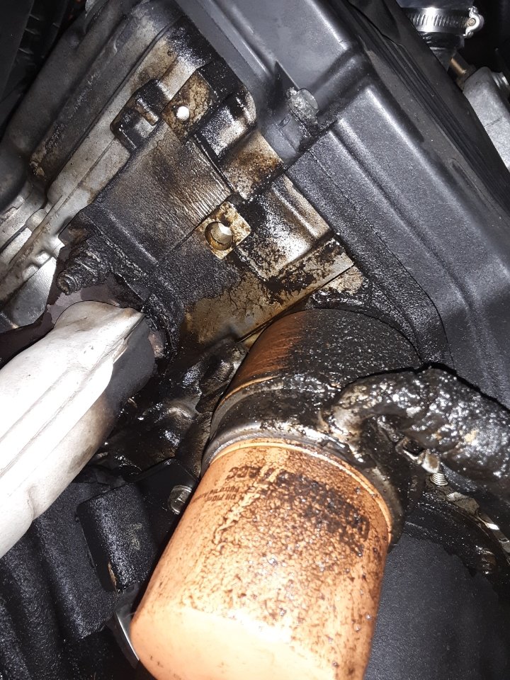

4Flats replied to 4Flats's topic in 1990 to Present Legacy, Impreza, Outback, Forester, Baja, WRX&WrxSTI, SVXDang, thought I got lucky. Looks like it has been running this way for a while. Learning every time I dig into this thing.

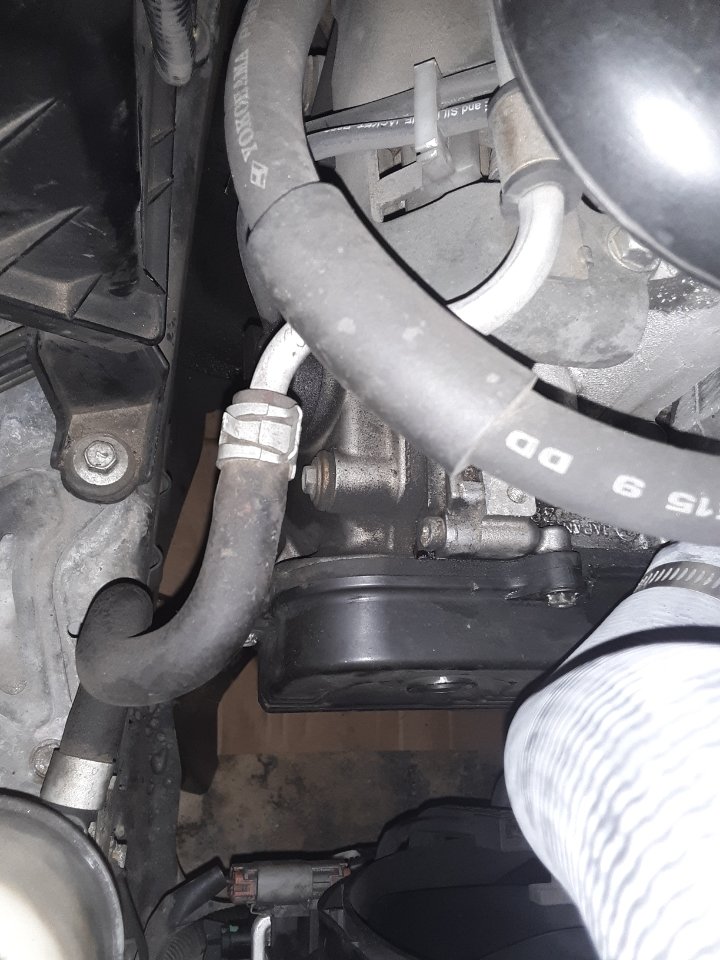

I picked up a 2005 Forester with 250K on the clock and I'm doing some digging around and found this leak. It runs great and I am in the process of going through the car. At first glance I assumed the worst but not I think it might just be a botched cam seal. It looks like some one may have installed a generic timing belt kit about 9 moths ago (Sticker on air box) and the seal either got missed or installed improperly. I'm new to these engines so any input is welcome. In the attached photos you can see the head and where I sprayed some de-greaser. Thoughts?
