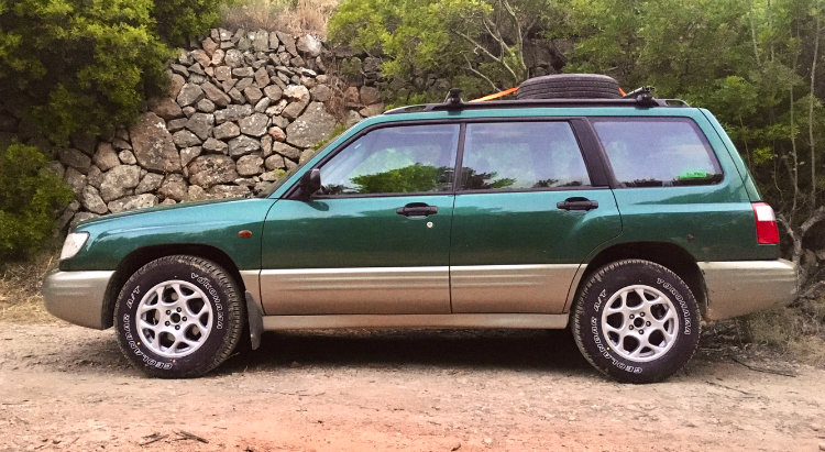

Been a long while since posting here, whilst getting on with some building and family projects. The green Forester is now up on all four KYB OB struts, new Forester springs, slightly wider wheels and the ever so slightly larger than standard Yokohamas. It sits plenty taller than before. It is really fine on the road, firm, stable and those M+S Yokos really stick the brick to the asphalt. The only slight problem is the apparent topping-out going over some abrupt bumps.

It really feels and looks like this is the correct size for these cars, with little change in the gearing due to the slightly larger diameter. The Forester still pulls uphill on rough ground in low ratio as it always has done. Tarmac feels smoother with the increase in wall height. -

I just fitted my new Yokohama G015 215/70R15 tires on the 48mmET 7jx15 rims that came off the silver forester (a dealer option). Very happy with the result: the tires are a published 14mm larger in diameter than the 205/70 they replace. Theoretically they are 2.2% larger in diameter, circumference, and speedo error. In actual fact they are a whole 26 mm larger. This is 4% difference in size, giving a speedo reading of 50 mph at an actual 52 mph. Negligible really. As a side note these Yokos run quieter and smoother than the General Grabbers they replaced, I have not yet tried them in the wet, but dry and loose surface A++. As a kitsch bonus they have white lettering which was unexpected. Physically they will just fit (clear) under our silver car’s standard Forester struts. This green car however has new KYB Forester SF springs on new Legacy Outback KYB Excel-G struts. More strut clearance and greater ride height in the rear. The front is getting small lift soon. -

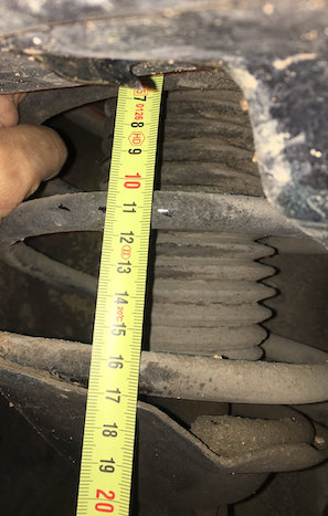

Can anybody shed some light on front springs’ loaded and unloaded lengths? I am about to swap the tired old original struts and springs for new KYB Legacy Outback struts and KYB Forester SF springs. Being a non-standard set-up, I am taking measurement before disassembly; The original front springs under the weight of the car show an overall length of 18-20cm (~7.5”). The brand new new uncompressed spring measures 38cm (15”). Can I expect the new springs to compress to almost half their length??? This, combined with Outback struts which give an extra 0.5” spring perch height, would appear to give me some brutal lift. Obviously the strut will limit the length of the spring to some extent. I’m hoping for some lift at the soft front end, but perhaps this will be too much. PS the rears were done earlier using the same combination of new KYB springs and Legacy Outback struts, and gave me around 2” of clearance, tire-top to wheel arch, no lift spacers. Thanks for any theories or knowledge in this matter. New versus old. Both new and old springs have roughly four turns:
