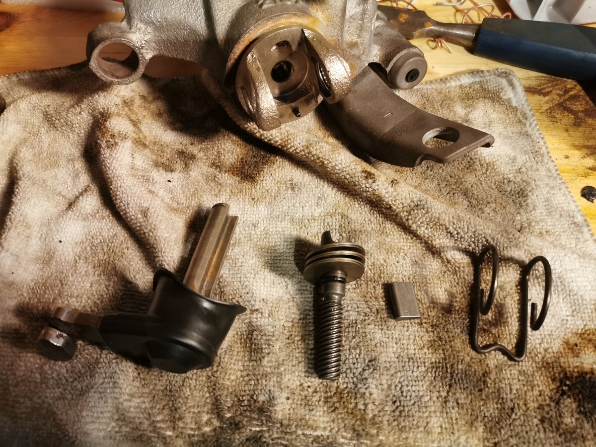

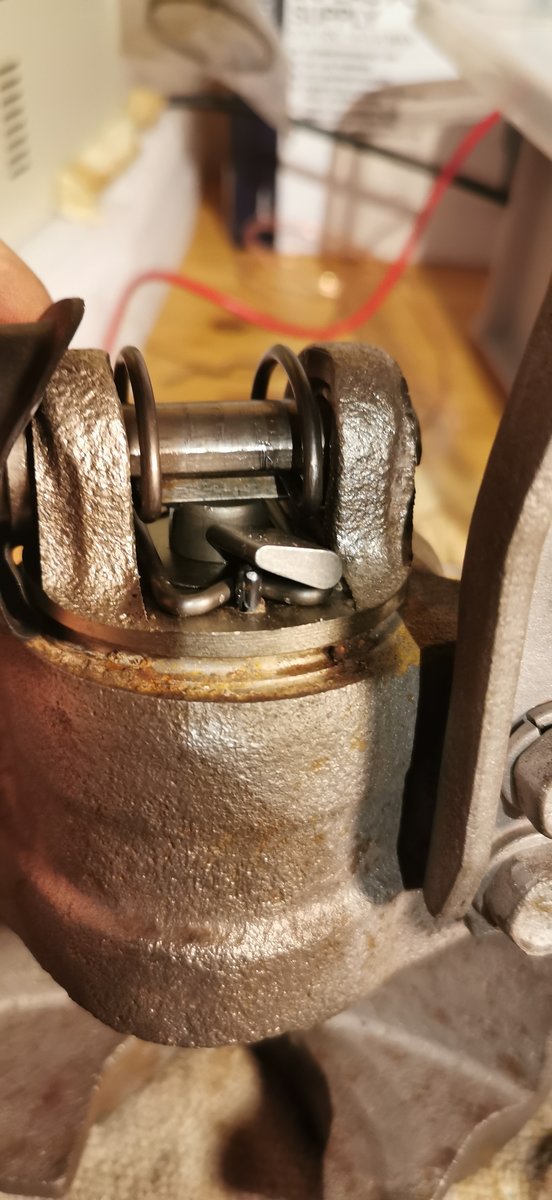

Hi, I need help to know how to put this together, have tried everything possible, but can not find any sensible picture what it should look like or what direction the lever should sit. Has anyone here done this before who can explain or have pictures from the assembly? - Subaru XT 1986 ea82T starts and goes too 3k rpm the drops to 0
