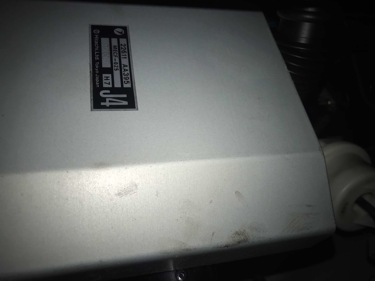

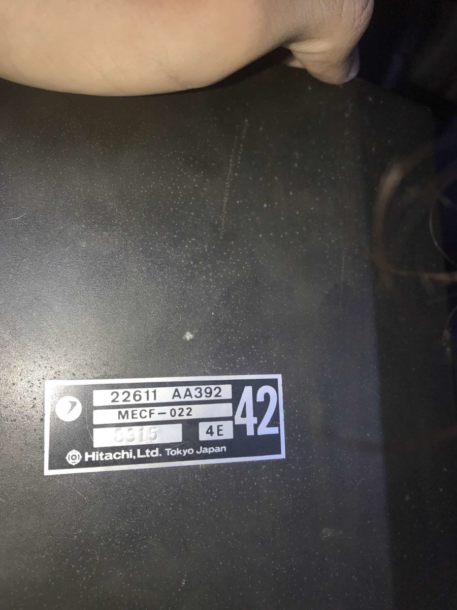

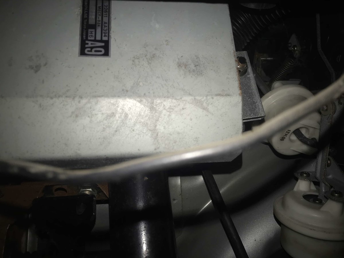

  15. I have three different spfi manual trans wagons, all are stage 2 (post wiring changes) and I need to know if the ECUs can be swapped around between them. Pictured are the ECUs in question. All have different numbering on the stickers. After some extensive searching I’ve been unable to find a thread which answers my questions. Links to threads which I may have missed are appreciated!
  16. All of the cars are manual so theoretically I wouldn’t have to rewire anything, it would just be plug and play right? What are the chances that I could damage something if I throw the problematic ECU into the 92? This would allow me to test for function and interchangeability before installing a good ECU into a car that could still have something shorting out that circuit and see if it runs everything but the CEL in the 92. If the ECUs are the same, and I know for sure I’ve fixed whatever damaged the original ECU, I’ll probably just use the one with the good CEL just for my emissions test, then switch back because the 92 is all original and I’d like to keep all of its parts together until that’s no longer possible.
  17. It seems highly likely this is what I did. Any advice on how to replace the transistor/IC chip? Or is the ECU no longer viable? If so, I have two other ECUs which are from a 90 and a 92 Loyale spfi manual trans. The systems that they run seem pretty close to identical but the sticker on the housings all have different numbers. Any info on spfi manual trans ECU interchangeably?
