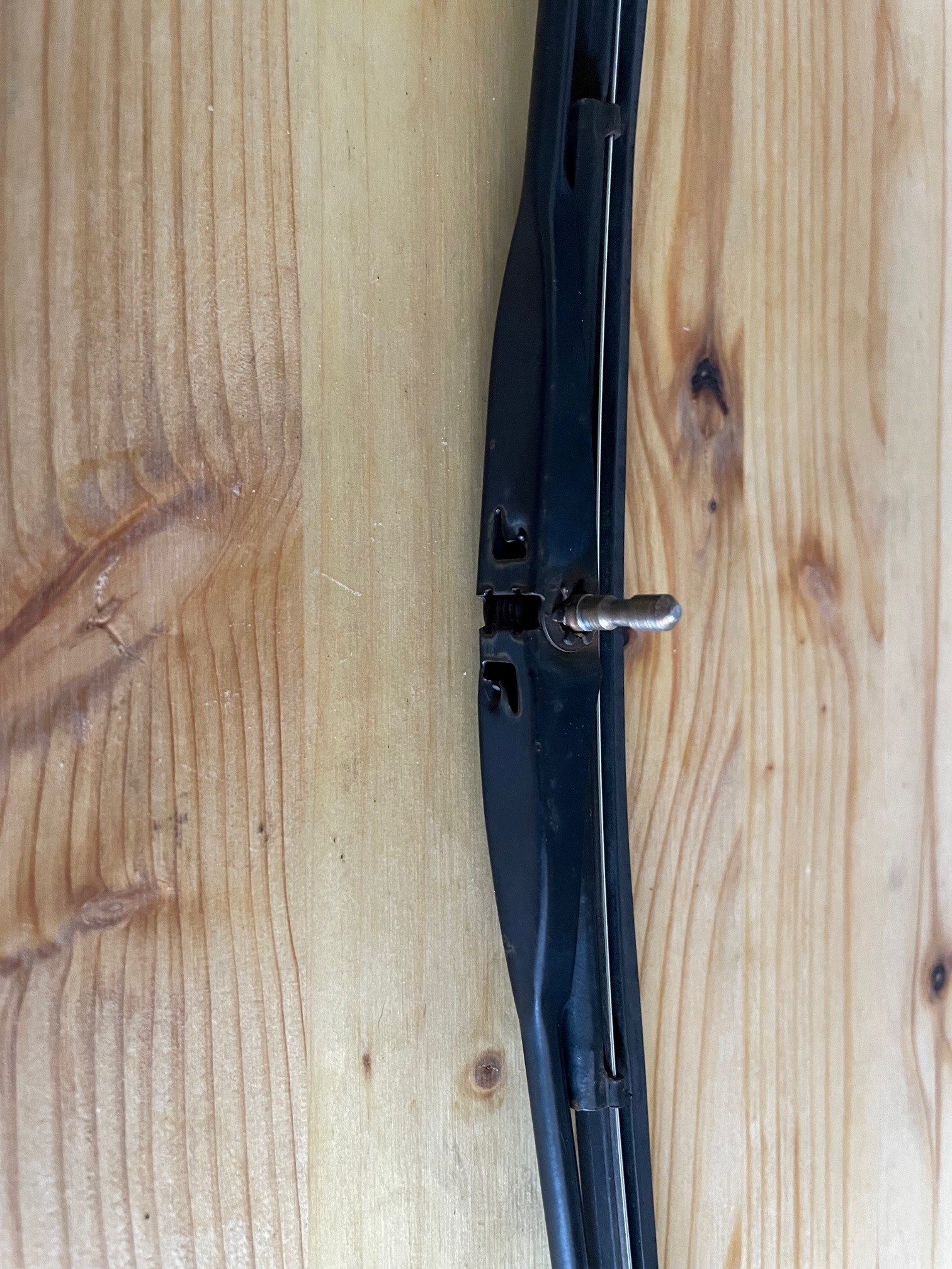

  1. Anyone know of other make cars whose wiper arms will work on our splines? My pin arms are tired and the wiper blades have had the rubber refills replaced so many times that the metal is nearly cracking. At minimum maybe where to find the pin blades as in picture to get new, soft ruber again. LOL
