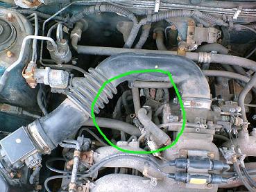

CMohan replied to CMohan's topic in 1990 to Present Legacy, Impreza, Outback, Forester, Baja, WRX&WrxSTI, SVXOh yeah, I don't know if it is too important, but my car is an automatic....also, I found a picture on the site that shows exactly where the smoke on my car is coming from...if anyone has a guess on this one, please help me....thanks in advance.
