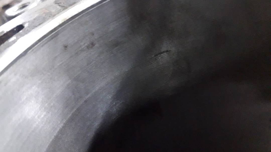

  1. Hi, so I was rebuilding a ej22e h4 engine from a 1993 Subaru legacy non turbo, I purchased 0.20 pistons and send the block to the shop and they send me back this photo, the cylinder wall still needs to be bored a little more and then brushed, what are my options? This cylinder is useless or this Will dissapear after brushing? Or this is coming from inside corrosion from the water holes inside the block, can this cylinder be sleeved? Will it affect the rest? I'm very disappointed after waited for 4 months the part since I got a lot of troubles with fedex. Thanks in advance
