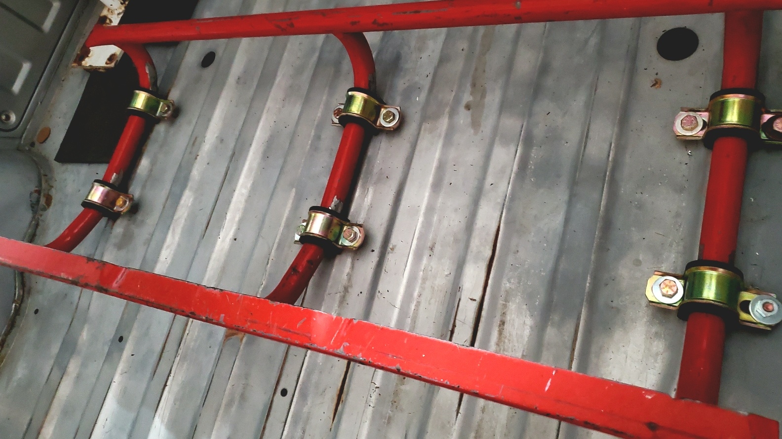

  2. Thought I'd share how I mounted my jump seat bracket using swaybar bushings. 6x 25mm bushings/brackets from eBay (~$50). Bolts/nuts/fender washers ($10) Ground off the original mounting tabs off the original brackets. Set the brackets location by test fitting. Benefits: diy friendly (no welding), removable, urethane adds a little comfort to the seat. Hope this helps!

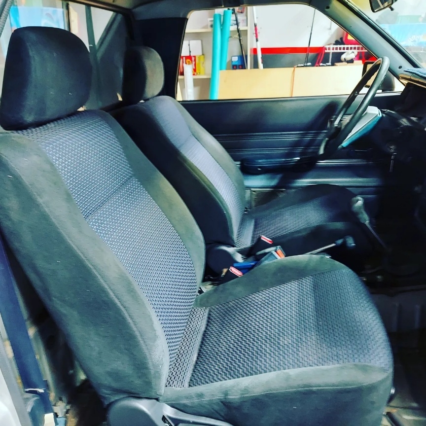

  3. Hey first post, but was proud of my work so thought I'd share... Installed some Mitsubish Lancer seats in my 86 brat. $40 bucks each from the junk yard! Was able to do it with a hand tools and a drill.
