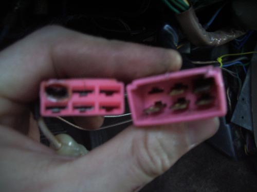

krankitup replied to krankitup's topic in Old Gen.: 80's GL/DL/XT/Loyales...
Well edrach you are my hero for the week! One wire on that connector was toast! I clipped it out and bypassed the connector. Works like a charm! Thanks everyone for all your help. Subaru owners are the most helpful people, I swear. I'm attaching an image of my connector if anyone cares to see it. -
Starter problems. '84 wagon
I've got all new ground cables from the battery to the engine block, from the battery to the body and I added a new one from the starter to the body. Still nothing. It worked tosay when I jumped it so I thought maybe it was the battery so I took it in to a different auto parts store to have it tested and the battery and the charging system checked out fine. I'll look into the ignition thing tonight. I hope I have enough daylight. I really need to get this thing working right. I sold my other car the day before all of this happened. I haven't had just one car for atleast 4 years. Anything else I can try it the ignition checks out? -
Ok, I've been having issues with my starter the last couple days. It works sometimes, other times it does not. It's an '84 wagon, EA81. When I turn the key the solenoid clicks. So I replace the starter because every time it's done that on my other vehicles it solved the problem. Well, the first new starter I put it does the same thing. I take it back and make them give me a new one and it still does it. I check all my cables and clean them. I replace that dinky little ground wire with a 4 gauge wire. That fixed it for a couple hours. I had my cooling fan wired to my coil, so I rewired it figuring somehow it might be drawing too much power from the starter. Still didn't fix it. There is a little box in the passenger side of the car in the back corner that seems to click at the same time of the starter, but I have no idea what this is or if may be causing a problem. I'm attaching a picture of it, maybe someone here can tell me what it is and if it's normal or not. Does anyone else have any ideas for me?
