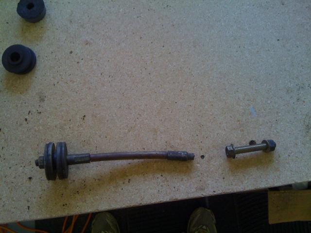

This is a super old thread now, but I'm going to resurrect it, since I now have pictures!
I replaced this with a stretch of cable (ultimate backyard mechanicing!), but didn't get it very tight. It may or may not hold or stay there. We'll see. I am going to try to find a replacement.
I had a friend of mine look at my engine, and watch while I started in 1st gear. He said that it looked like my pitch stopper was loose. I replaced the rubber with some custom rubber made out of stoppers, and tightened everything down. I haven't taken it for a test drive yet, but the pitch stopper is definitely tighter than it was. Hopefully this helps. If not, I'll look more into the DOJ.
