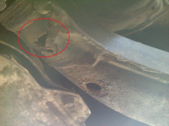

August 1, 201114 yr The top and sides are solid... how big of a deal is this? should I worry about it snapping? I really dont want to replace the control arm if it will get me by for a while as is...
August 2, 201114 yr Yeah, that needs to be fixed NOW. One good pothole could give enough force to fold that, and you will need a lot of new parts if that happens, if you don't swerve into oncoming traffic as well. Control arms are easy to replace.
August 2, 201114 yr Just grab one from a junkyard. Find one with a good rear bushing so you don't have to remove that big nut on the end. That one is a PITA. The rest comes apart really easy.
