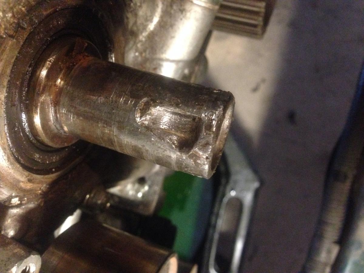

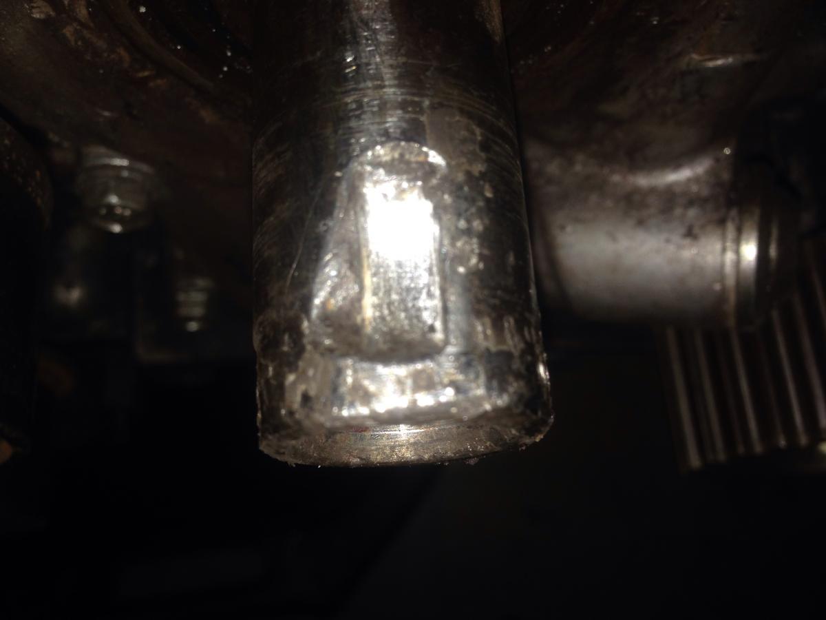

I got the gear off. Is that key way too messed up to reuse the crank? I took the key out of the other engine to see how it fits and it looks pretty good. post-52275-0-18741000-1393698393_thumb.jpgpost-52275-0-92975100-1393698487_thumb.jpgpost-52275-0-30128100-1393698540_thumb.jpg
Oh that ones still in good shape. The one on my 95 is like that. The pulley runs a little weird, but that could be because its a junkyard pulley.
I've seen pictures of much much worse.
File down the rough spots and fit a new key with a little JB weld on that worn side. Let it dry then file it smooth so the new sprocket and pulley will slide over it.
