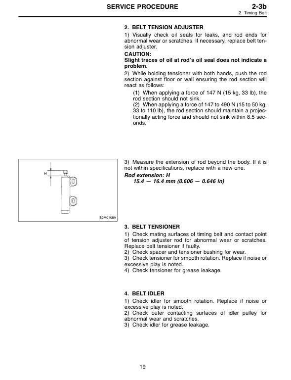

best way to check a tensioner is to remove it and put it in a vice to re-compress it. It should take at least three minutes to compress, as long as you don't force it. If it compresses too fast/easily, its bad. personally, I would replace the tensioner and idlers whenever I do the timing belt, as they are the most common failure points. I can try to find the service info on it. I just glanced at it because I simply replaced my tensioner, however I know theres a procedure.

EDIT: FORGET WHAT I SAID ABOUT THE 3 MINUTE THING, I FOUND SERVICE INFO
Edited by pginter96
Here, straight from Subaru service info. This is for a 97 EJ25D, Tensioners SHOULD be the same, but Im not 100% positive. Procedure should still work.

This went fine for a little after the rebuild then it had a ticking noise that turned out to be the timing had slipped on one side.  From one of the posts I am now certain the tensioner is weak, it is pretty easy to push and can do quickly.  BUT now with new noise that sounds similar to a rod knock ,but not if you know what I mean and running, the noise is behind the tensioner, either oil pump (new) or something at rods.
