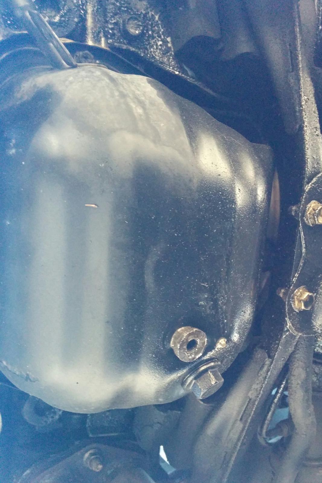

I am at the junkyard right now and there's four candidates here that I could use but one of them has a big dent in it and the other three have this extra plug.(see photo) I don't understand what the plug is for. Does anyone know what it is?
The extra plug is where the damn junkyard punched a hole in it to drain the oil.
I hate that. There's a drain plug right there and they put a hole in it anyway!!
That is so lame.
I'm just gonna order an aftermarket one instead, At least I got some practice on how high I can lift the engine/transmission on a junk car. Those screw's are going to be a turd to get back in..
