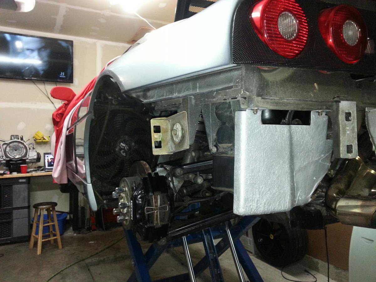

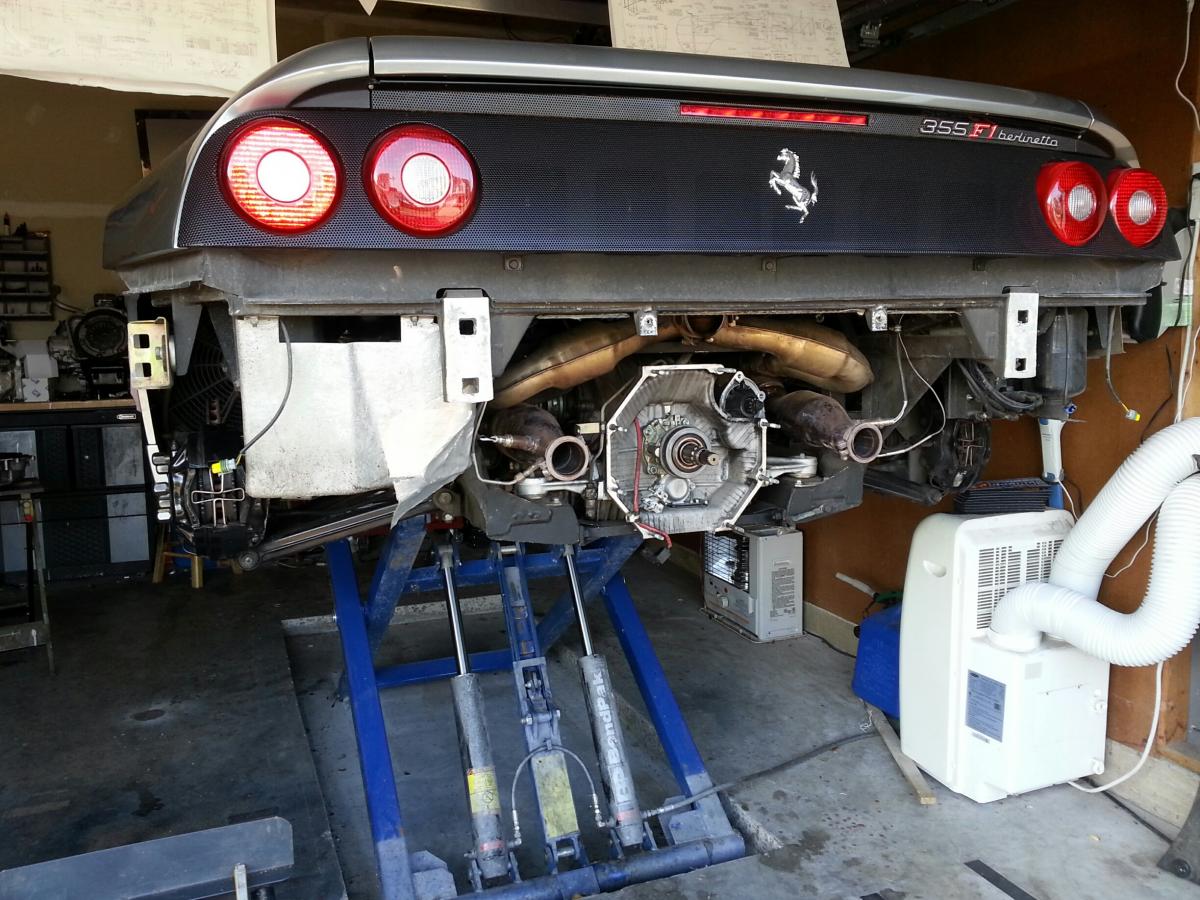

Car with the system installed, freshly painted heat shield, and you can see the EA81 on the bench.

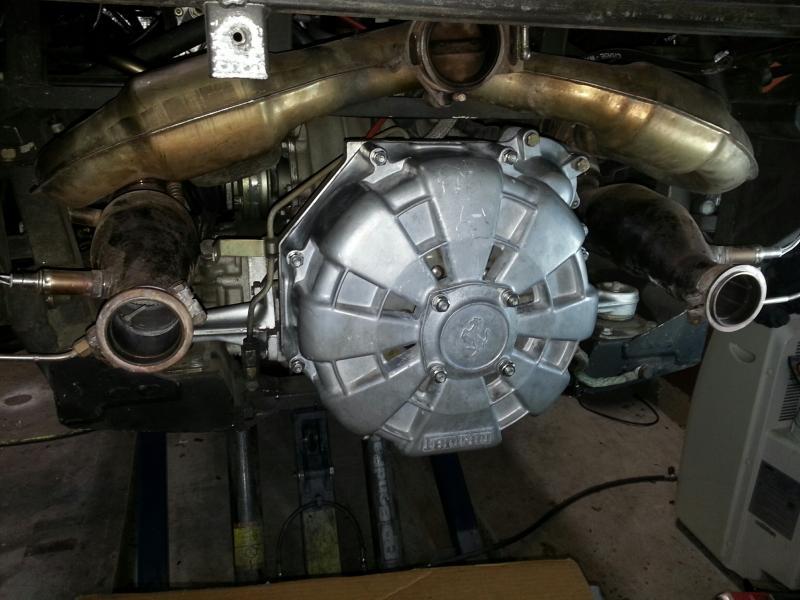

This view shows the clutch and exhaust removed. The layout is different in that it is engine, tranny, clutch instead of engine clutch tranny as the world usually works.

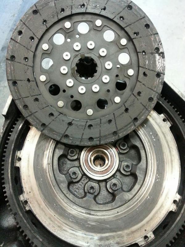

What lead to the whole project was a leaking seal that let tranny fluid onto the clutch disk and sensor.

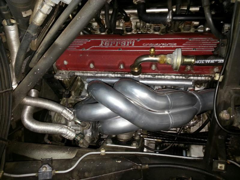

Installing new headers, as long as things are apart it is a nice time to do some cleaning.
