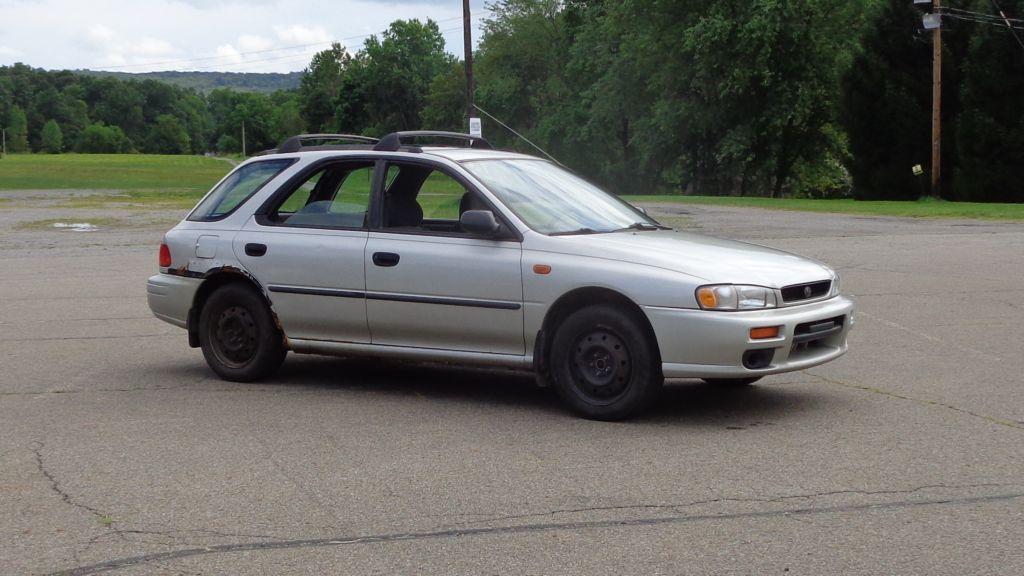

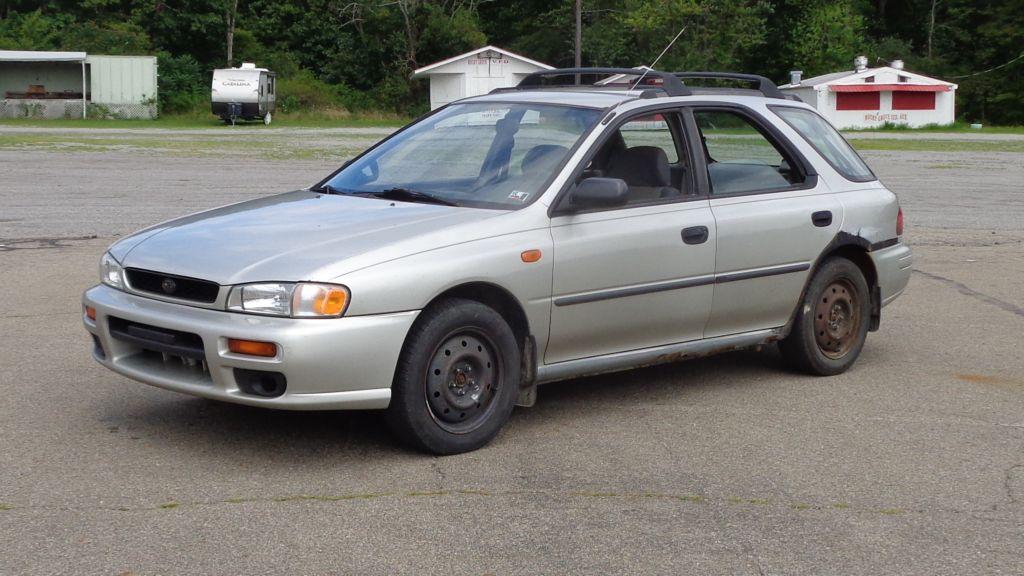

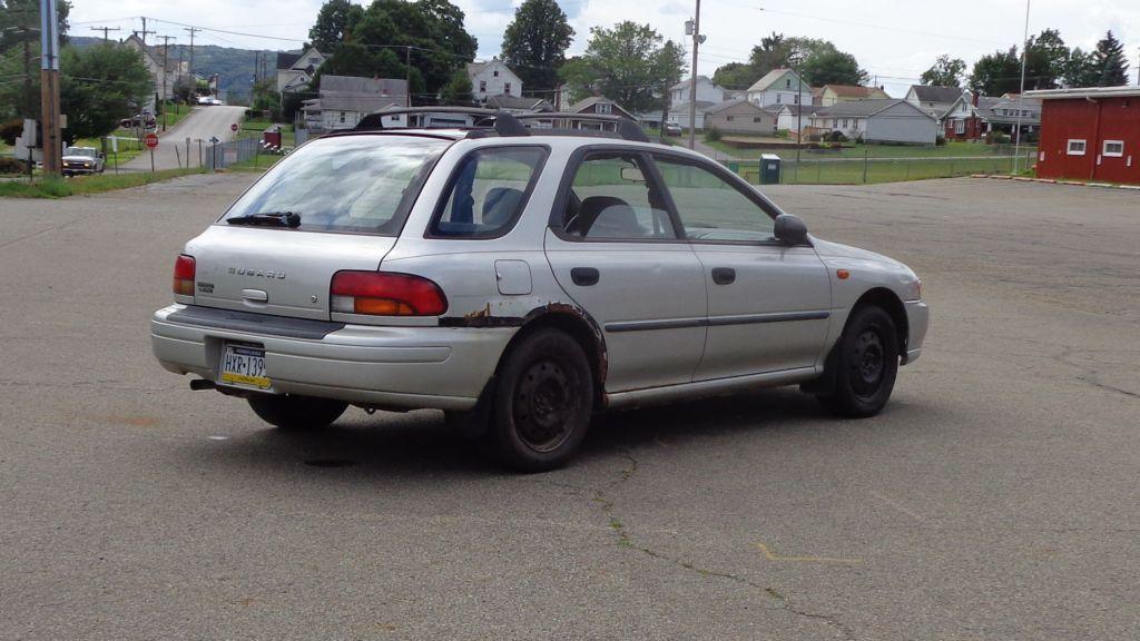

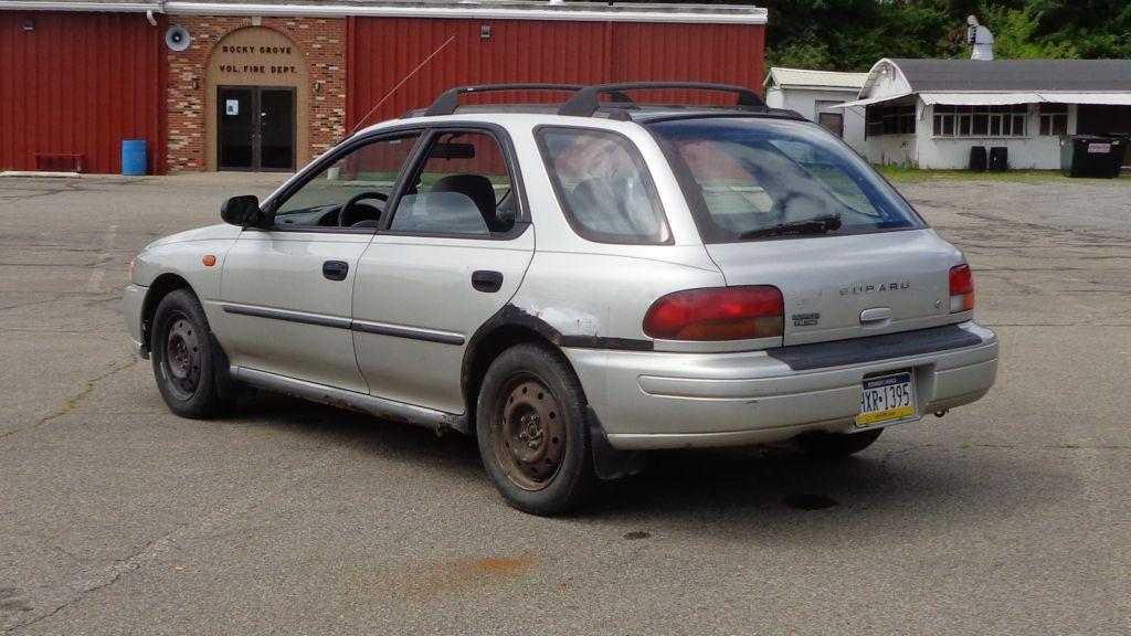

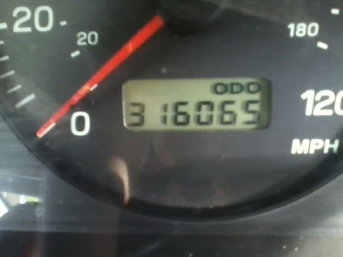

August 22, 201510 yr Hey Guys & Gals i recently got a 2001 impreza L Wagon AWD.2.2L Automatic 316,065 miles when bought, she has an issue running, cylinder 1 doesnt fire, previous owner said he bought it that way and has driven it for a year. i paid $250 for it and inspected till december, i would like to get her running properly father thinks its a burnt or bent valve.. because i get 30 psi 60 at best cylinder 3 gets 150psi runs on the same cam.. i was also told timing could do this as well, just a few teeth off can cause it.. what do you guys think ? EDIT: Edited August 23, 201510 yr by SubaruJawn
