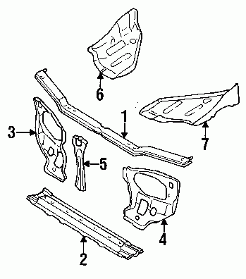

Rear ended a car (Forgiveness Please) and crunched in the front end of my 95 Legacy Wagon.  Been trying to find how to REMOVE the radiator support assembly.
A parts warehouse diagram shows it as top bar, middle bar, and lower bar plus the covers on either side where the headlights go.
The top middle and bottom seem to be all of one piece and I can't tell where to separate it from the fenders and rest of the car.  I've got the bumper assembly off.
The radiator support assembly pushed the radiator up against the pulley wheels.  I managed to pull it back out with a come along fastened to a tree.
I can get the radiator out now but am baffled (I'm easily baffled) on how the support assembly is attached.

Suggest you go to a wrecking yard. Cut out a radiator support from any Leggie 95-99, then swap it into your car. You will need to have it welded in. Package the rad support with other items you need replaced on the front end, shouldn't cost much. Don't be surprised that you find you may need to replace the radiator as well, since it got pushed around as you described. Very easy for it to leak.
