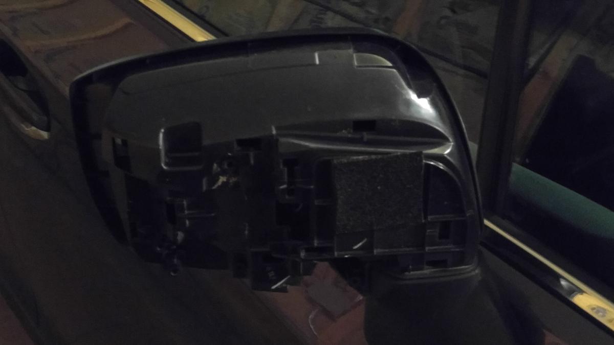

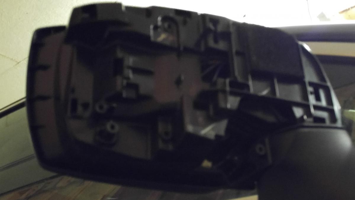

July 29, 20178 yr Somehow the back side of the passenger side mirror was knocked off my 2016 Legacy. The mirror itself isn't broken, and all the electronics still work. Does anyone know the part number I would need to replace the missing piece? I don't need to replace the whole thing, just the back cover portion.
July 30, 20178 yr devtrv27, Go to Subaruparts.com and input the year, model and trim and follow the lists to the Body section, Outside mirrors. The issue is whether you have black covers, or painted, and whether you have built in turn signals or not. When you check the lists you'll see that each option has a different part number. Make sure you get the correct side, and be aware that any colours have to be painted, other than the black. Good news is that the parts are cheap, less than $6 each! Good Luck!
