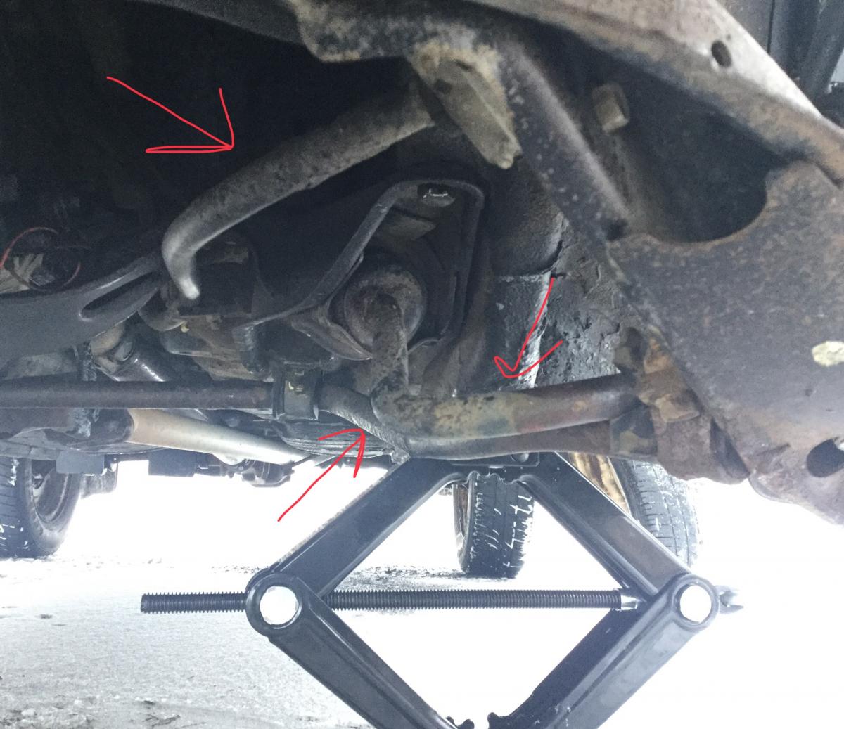

Took a corner a little to fast last night and locked up the brakes. Slid and hit a curb, which did all this
I bent my Control arm, possibly my strut, and inner tie rod
The red arrows are steering parts that are bent and need but I don’t know what they are called. Anybody have a donor Wagon in/near Spokane that I could scavenge off of for not too much money? Or by chance does anybody have these parts on hand? I’m gonna look at pull n save but I don’t have much hope. Also, I am in A&P school so I’m on a pretty tight budget...post-54976-0-57400300-1519489320_thumb.jpeg
The top arrow is the E-brake cable.
The left arrow is the swaybar, it may be a bit bent, but it will probably still line up and work fine.
The 3rd arrow is the radius rod.  You will need a new one.  You will likely need a new control arm too.  You will want to inspect the radius rod mount point.  I would repalc ehte balljoint and maybe tierods on that side too.  They took a heck of a hit.
Sometimes when this type of thing happens, the plate in the mount that the rod goes though gets pushed back, dished in so to speak. So you may want to stack one or two large washers in there to push the rod forward to where it should be.
Lol I’m a moron. Yup that top one sure is the brake cable.
Yeah the control arm is twisted so gonna need a new one. Would a 1982 wagons steering components be compatible? According to the web there is one at the pull n save here in spoky....
Thanks for the tip about that radius rod
