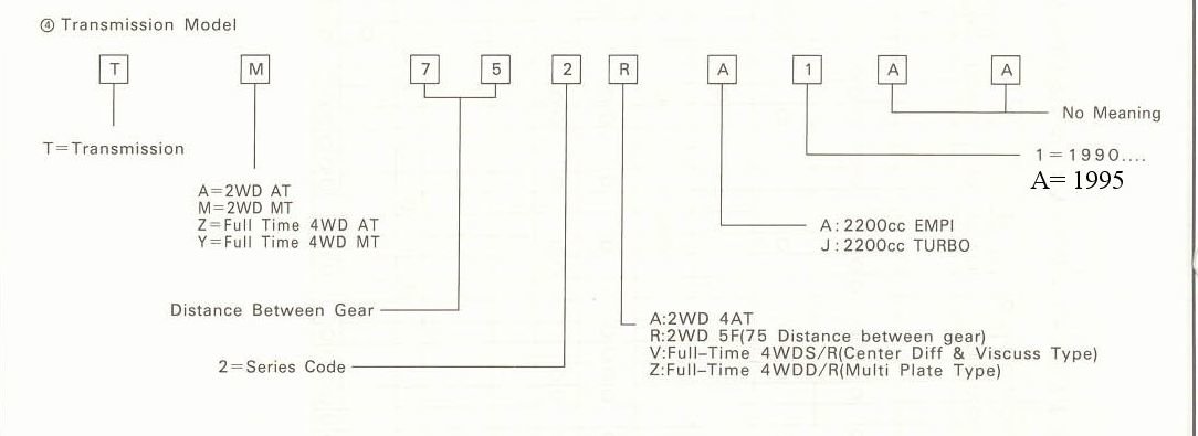

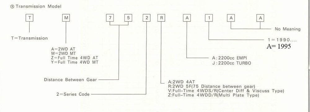

If you go shopping for a transmission, there is a sticker on the bellhousing above the starter. Write down that code. The first 6 digits are very important.
The code on our 4EAT is TZ102Z.
Ask them if they can drive out the roll pins and leave the axle stubs in the tranny differential. Otherwise you will have to reuse the ones from your old tranny.
