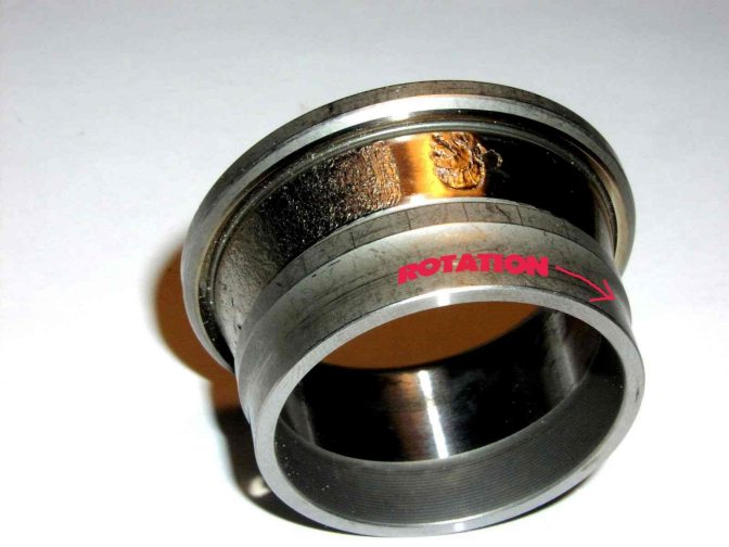

December 18, 200322 yr Author Alia176, Nice pictures of the job and your shop. I wish I would have thought of pictures while I was busting my knuckles. Only thing left to take a picture of is the screwed up inner race that caused all the noise. Hope attaching it to this message works. If not, someone tell me how to do it. OBW99, The hub tamer should let you push the axle out of the hub. Mine came out easily. Again, I used a Subaru bearing and did not repack it. Only time will tell if I did the right thing.
