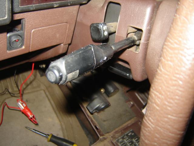

rrgrr Posted April 10, 2014 Share Posted April 10, 2014 You have no accelerate switch on yours, and there is no dash button, just the steering wheel control shown? Was there a tail for the dash switch in your harness? My stalk control has set, accel, coast. It is sort of heat shrinked on the turn signal. A friend's car has the exact same setup as mine -it's an '86. Quote Link to comment Share on other sites More sharing options...

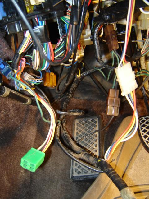

Discombobulated Posted April 11, 2014 Author Share Posted April 11, 2014 Any yards near you to swoop up a system? The problem I see testing it is always you need to be driving to do it:) I don't quite understand how the vss knows that I'm going over 25 with a mechanical speedo but maybe that's something in the cluster doing its thing? I was wondering what your plug going to the stalk looked like, so on mine I have a flat 3 wire plug going to the switch on the left of the cluster and then for the steering wheel buttons it is factory wiring through the wheel and has a plug sticking out of the harness the cruise harness plugged into, so 2 separate spots on mine is kinda 1 spot on yours going to the stalk, right? And I don't think I asked or I missed it but is your tach wire hooked up to the coil? Quote Link to comment Share on other sites More sharing options...

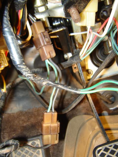

rrgrr Posted April 11, 2014 Share Posted April 11, 2014 My stalk switch has a 4 wire harness red, yellow, blue, white. It is the white plug in pic 4. That part is just routed up the steering wheel and heat shrinked to the turn signal stalk, switch stuck on the end. The black & yellow wire plug you pictured is in the background. The yellow wire breaking out ahead of that is going to the coil -. From what I can tell, this harness is completely isolated except for the brake light breakout. Hard to tell if that wire is connecting the tach to the coil directly or if it is a feedback system routed thru the vss without stripping the harness(not inclined to). Looking for some kind of test for tach signal to vss when parked. [but I'd rather be driving.] Quote Link to comment Share on other sites More sharing options...
Discombobulated Posted April 11, 2014 Author Share Posted April 11, 2014 Hmmm, my wire was a separate yellow with white stripe(I think white stripe) ran out to the bay and had an open ended hook connector to mount directly to the coil negative side, definitely didn't do squat without it. Ahh I see the wiring going to the wheel now so I take it mine has 5 total wires just to ground the switch for the cruise light to light up. Weird the tach set up is different though but I would imagine there is a - coil wire somewhere I could tap into like the cluster but it was made to go to the coil so that's where I put it. So indeed we have some differences in the harness but all the set ups I have seen at the yard all went to the tach, hmmm might be another thing to verify I guess:) Well poop, you need cruise!!! Now it's a quest!!!! Quote Link to comment Share on other sites More sharing options...

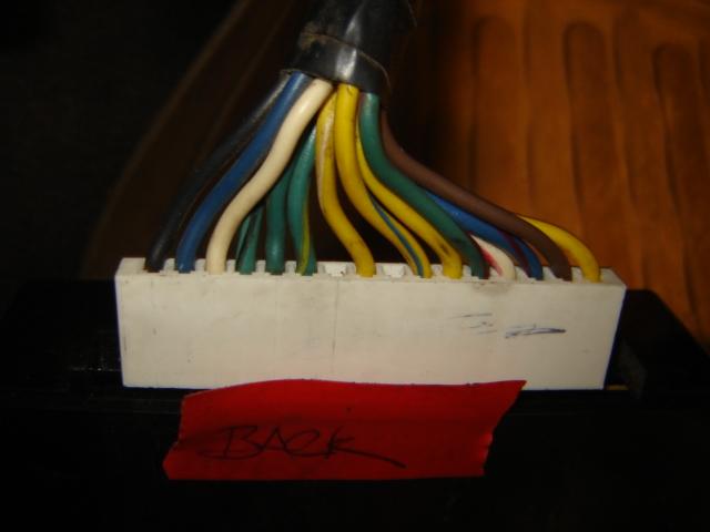

rrgrr Posted April 11, 2014 Share Posted April 11, 2014 Yes, the wire is yellow/white to the coil-. The harness I have is 14 pin. Here is what I have so far: The 4 in the pic here from the right are Y,Brown, B/R, W/R -to the vac switch; then there are G/R-power; Y, and Y/B, Y/W - the latter 2 react to the switch,(I think this group(yellows) is the tach send/return(?)) the G/Y pair next to that are brake switch, G/Black,(?),W & B -Switch, Black -Ground I have my 'guesses' in parenthesis. The tach connection is different from the coil connection? Can you describe the tach connection, or are we talking about the same thing? Quote Link to comment Share on other sites More sharing options...
Discombobulated Posted April 12, 2014 Author Share Posted April 12, 2014 No same thing, I just say tach wire because the brain labels it as tach overspeed... But your harness pin outs are definitely different but I would imagine internally and color coded the same, looks that way anyway. I am getting under my dash tomorrow finally and I will snap some pics of my harness and other stuff:) Quote Link to comment Share on other sites More sharing options...

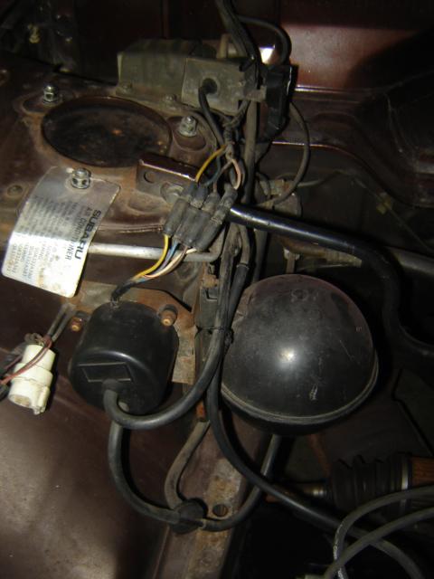

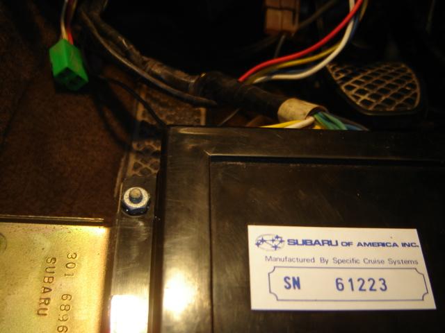

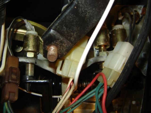

Discombobulated Posted April 13, 2014 Author Share Posted April 13, 2014 Here is some more pics of the brake sensor stuff, another pic of the pins and of the vacuum wiring under the hood:) Quote Link to comment Share on other sites More sharing options...
elgigante Posted April 14, 2014 Share Posted April 14, 2014 That last picture of the vacuum for cruise control. Where is the hose with the red clamp going into? Quote Link to comment Share on other sites More sharing options...
Gloyale Posted April 14, 2014 Share Posted April 14, 2014 That last picture of the vacuum for cruise control. Where is the hose with the red clamp going into? One is the Vac supply from the engine.......the other is vac "output" to the diaphragm mounted at the gas pedal. There should also be a large round black plastic canister/resevior "T"d into the supply line.....I don't see it mounted there? Quote Link to comment Share on other sites More sharing options...
elgigante Posted April 14, 2014 Share Posted April 14, 2014 (edited) It could be turbo. So it could be like Mine Edited April 14, 2014 by elgigante Quote Link to comment Share on other sites More sharing options...
elgigante Posted April 14, 2014 Share Posted April 14, 2014 So the vac coming from that gets hooked up to the bottom vac line on the black cruise control thing mounted on the strut tower? Quote Link to comment Share on other sites More sharing options...
rrgrr Posted April 14, 2014 Share Posted April 14, 2014 See Pic 1 in post 26 above^^ Quote Link to comment Share on other sites More sharing options...
rrgrr Posted April 14, 2014 Share Posted April 14, 2014 It could be turbo. So it could be like Mine That is A/C stuff. Quote Link to comment Share on other sites More sharing options...
elgigante Posted April 14, 2014 Share Posted April 14, 2014 (edited) I was told that black ball thing wasent used for turbo models because thats pretty much where the turbo is, it would melt.where would that be for turbo models? There is supposed to be a Check valve and an extra resevior to work inthe turbo models......Although....the extra canister is bulky, close tothe turbo.....so it get's ditched. Edited April 14, 2014 by elgigante Quote Link to comment Share on other sites More sharing options...
Discombobulated Posted April 15, 2014 Author Share Posted April 15, 2014 Here is the big canister and where I tapped into the vacuum, think it's correct and it made sense but I'm sure it can go anywhere:) Quote Link to comment Share on other sites More sharing options...
rrgrr Posted April 15, 2014 Share Posted April 15, 2014 I Am Cruising! Strangest thing...or not -I don't know but I think I am smarter now. Put my dash back together since I wasn't really getting anywhere parked, (no pun intended) Went for a drive to play with it -nothing. So I tried the horn to check the fuse -instead of the horn the seat belt light lit! Hazard light made the sb light go on, too, no hazards, weird. Don't know if that is by design, but I put a good fuse in and all is normal there. There is something odd about this dealer hookup, not having a master switch, and I got a clue when trying to pin out the harness, -(I won't go into it) after thinking my switch was shorting,or whatever else, trying every combination, I decided it has to do with the sequence of switching: The Set switch will Not set cruise if the last switch used was Coast. I was able to consistently play with set, acc, coast, acc, etc, as long as I did not go back to set after coast -had to flip it to acc first -not long enough to accelerate, just to reset the system somehow. Anyhow, cruisin' is the shizz! Thanks for the help and hope this gets others cruising, as well. Quote Link to comment Share on other sites More sharing options...
