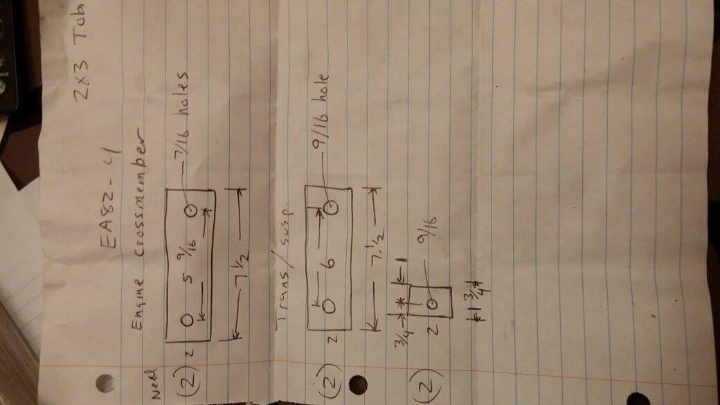

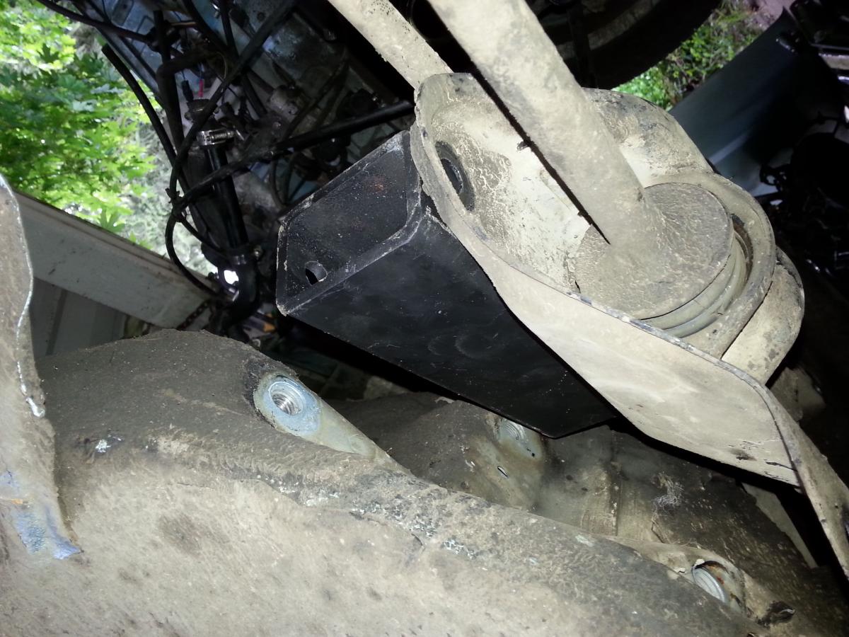

kirzick Posted May 25, 2014 Share Posted May 25, 2014 Im installing a 4 inch lift on my project loyale. i cut the block according to Nicks instructions. So the question is, is this where they go? It would make sense i just want to make sure. I assume the smallest block also mounts here. Thanks! Quote Link to comment Share on other sites More sharing options...
bratman18 Posted May 25, 2014 Share Posted May 25, 2014 The 2 longest go on the front crossmember. That one goes there, and the smallest goes to the outer edge. Same for both sides. Quote Link to comment Share on other sites More sharing options...
kirzick Posted May 26, 2014 Author Share Posted May 26, 2014 The outer edge of the same bracket correct? Also i used 7/16 steel allthread to do the engine crossmember. Will this be okay? Quote Link to comment Share on other sites More sharing options...
bratman18 Posted May 26, 2014 Share Posted May 26, 2014 Yeah the outer edge where there's only one bolt hole available for a block. You ideal want grade 8 hardware for those, so if it's cheap stuff, you may want to redo it. Quote Link to comment Share on other sites More sharing options...
