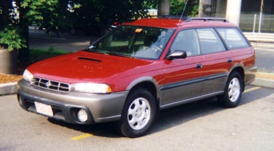

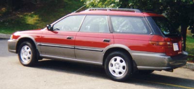

Are the side and rear badges stuck on with that foam tape that dealers use for their nameplates? I've peeled these off of every vehicle I ever owned without incident, but wasn't sure if the Outback labels were the same type.
Has anyone out there "de-badged" their Outback? I'd like to see some pics.

I don't mind the one on the front grille, but all the others seem like overkill. I don't have the "Legacy" badges- they quit putting those on at some point.
I was thinking about getting the rear windows (back doors and cargo area) tinted at some point, so I'll probably end up removing the stickers as well.
Anybody got pics?

Posted 13 September 2004 - 03:19 PM
No stripe, decal, grille badge, crossbars on roof rack.
