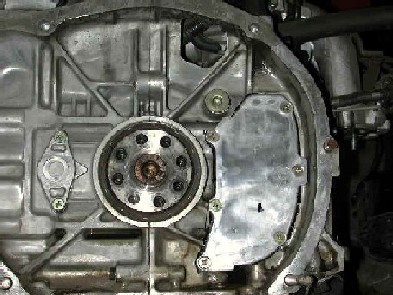

color-blind Posted June 3, 2005 Share Posted June 3, 2005 Here is a picture of the rear of a Legacy engine with the aluminum plate. Quote Link to comment Share on other sites More sharing options...
mwatt Posted June 3, 2005 Share Posted June 3, 2005 Here is a picture of the rear of a Legacy engine with the aluminum plate. what is this "iATN" log-in thing that we get when we attempt to see this picture?? Quote Link to comment Share on other sites More sharing options...
idosubaru Posted June 3, 2005 Share Posted June 3, 2005 how did he decipher the seperator plate as the source of the leak? it also doesn't make sense that this thing should leak enough to need replacing. can't think of any way to differentiate seperator leakage over rear main seal. the seperators that i've seen aren't under any constant oil pressure or supply either, more or less a vent/drainage back to the oil pan, i can't imagine it leaking very much. i've pulled 200,000 mile motors and the most i've seen is some wetness, no major leaks from these things. i've owned many soobs, worked on other subaru's and i'm a moderator at http://www.xt6.net and i've never seen or heard of anyone having a seperator leak fixed. i know people (myself twice) that have replaced it only because the motor was out for some other reason though. if this is even possilbe, it is very rare indeed. i would get a second oppinion. how much oil are you leaking? Quote Link to comment Share on other sites More sharing options...
color-blind Posted June 3, 2005 Share Posted June 3, 2005 http://www.ultimatesubaru.org/forum/attachment.php?attachmentid=2603&stc=1 Try this. Quote Link to comment Share on other sites More sharing options...
